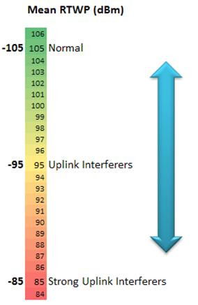

What’s the worst RTWP value I can pick up interference source?
The affected cells are on -94 to -96, but it’s difficult to pick anything when hunting.
Less than -90 can be considered as worst.
Could it be perhaps jumpers or cable issues not necessarily external interference from illegal installations?
Cause may be VSWR or Load on network.
Or may be TX RX port swap will cause.
Mostly in case of VSWR RTWP will be below -75.
Thanks. So at -94 to -96 am not gonna pick up anything on spectrum analyzer. Got it.
Below -75 or higher -75?
-70 is higher than -75
Kind of tricky. ![]()
Yes, that I know.
I was asking the affected RTWP values in terms of hunting, at what values does it have impact on the network at what is the most affected value I can pick it up when hunting?
Above -95 is always good also check RSSI value.

I just found on the field interference values higher than -80 dBm.
The worst has been found almost -60 dbm in our NW
FFT Scan can be done from the back office and FMA can be used for analysis showing PIM Interference, Wideband External Interference, and Narrowband External Interference. But U can get a low as -60dbm which would probably be due to poor installation on site.

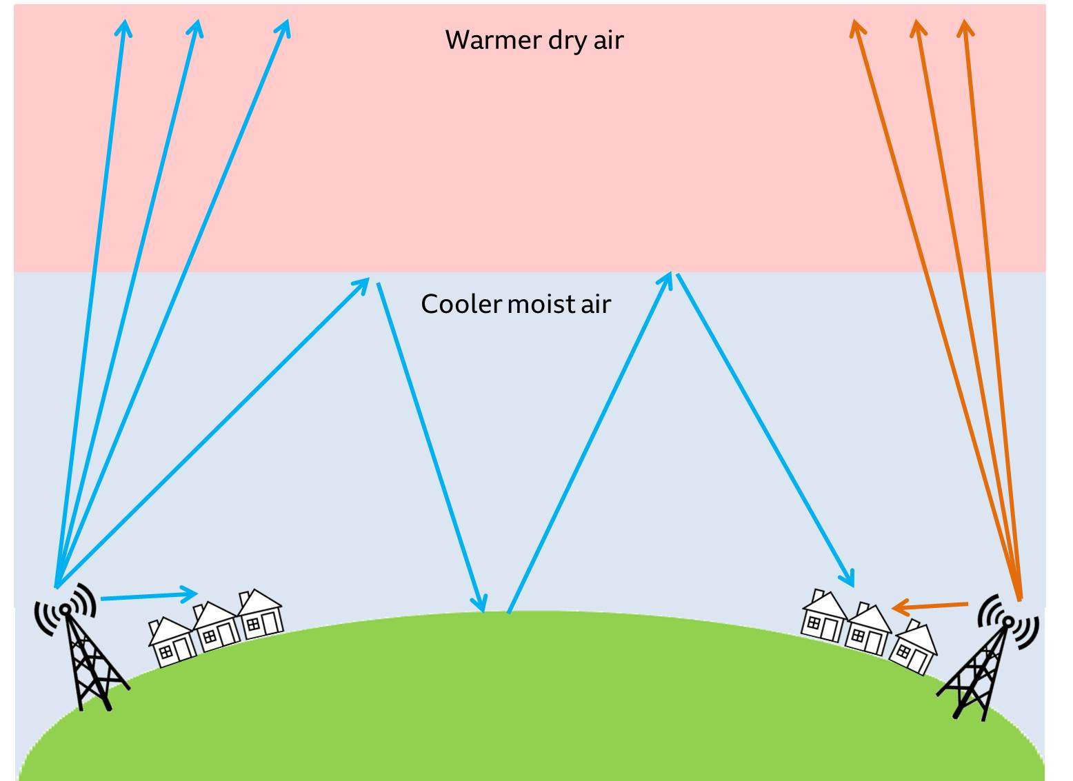

Also look if ducting is there or not.
