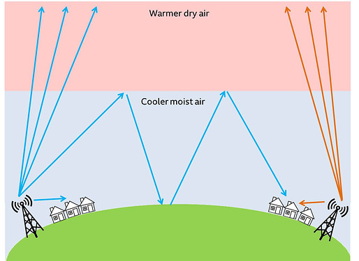

Hi Experts,
Just an inquiry about atmospheric ducting impact in TDD layers.
I have observed its impact on UL interference for 4G.pls suggest if any feature and parameters available to deal with this issue.

If the whole area is affected, go for the feature activation or changing frame type.
If only 1 or few sectors (covering same area) is affected, make site health check (jumpers, feeders, connectors, alarms, vswr, external source of interference.

It’s mainly due to storm in now a days storm is very frequent.
Any other suggestions which will reduce this ducting effect (it is “atmospheric ducting” phenomenon).

It seem shat 3GPP seriously considers issue with this phenomena in 5G networks (especially TDD) and in rel16 we will have: Remote Interference Management (RIM) and Cross-Link Interference (CLI) Management: Introduces techniques for managing interference from distant cells in Time Division Duplex (TDD) networks in the presence of tropospheric scattering, as well as managing inter-operator interference.
Mostly there is no sure shot way to mitigate TDD interference but what you can do is try to findout which ENBs are acting as aggressors. We have developed a few tools inhouse to find out agressor with the maximum number of victims causing TDD interference. Once you identify your consistent aggressors than you can apply various mitigation techniques. But mostly as the TDD interference is subjected to weather/tropospheric duct and many other things. More often than not we find only a little relief
Anyone having new idea or mitigation plan?
All Vendor developed the ducting mitigation feature to convert SSF7 to SSF5 during the ducting. Best solution is " Based on trace server report we need to do the Physical optimization of TDD site aggressor sector " .
not sure on Nokia There has feature available or not, in ZTE we can shift SRS to last symbol with enabling Feature “TDD Atmosphere Ducting”, it will be help full for reducing ducting impact
Its available in Ericson , Nokia , ZTE and Huawei…
