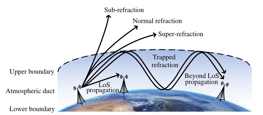

Hi, we are facing it here in Iran on L2300 & L2600 bands.
Interference is mostly coming from Arab countries across the Persian Gulf.
We have implemented some features and trials to suppress the impact of interference on major KPIs.
Does that means Interference due to very large overshooting coverage that create time delay shifting?
Yes exactly.
TDD systems are generally more prone to this type of interference as due to reflection of radio waves by atmospheric layers and the increased time delay, Downlink subframes of a remote eNodeB (in another country) can overlap the Uplink subframes of your network causing major KPI degradation.
