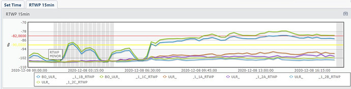

What's the worst RTWP value from interference source?

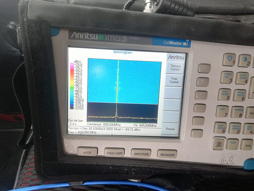

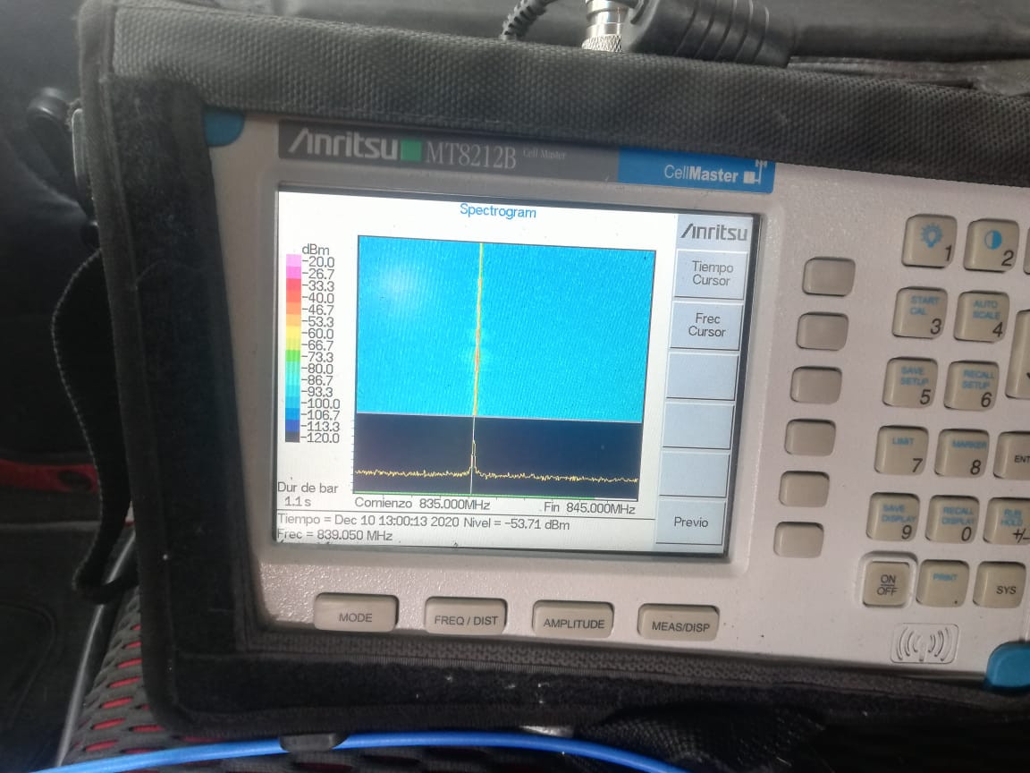

For external interference, if possible, visit on highly impacted site location and use Spectrum Analyzer and connect with your Antenna.
Did you identify the suspected Direction?
Better with espectrogram.
If you have high RTWP your issue is external interference.

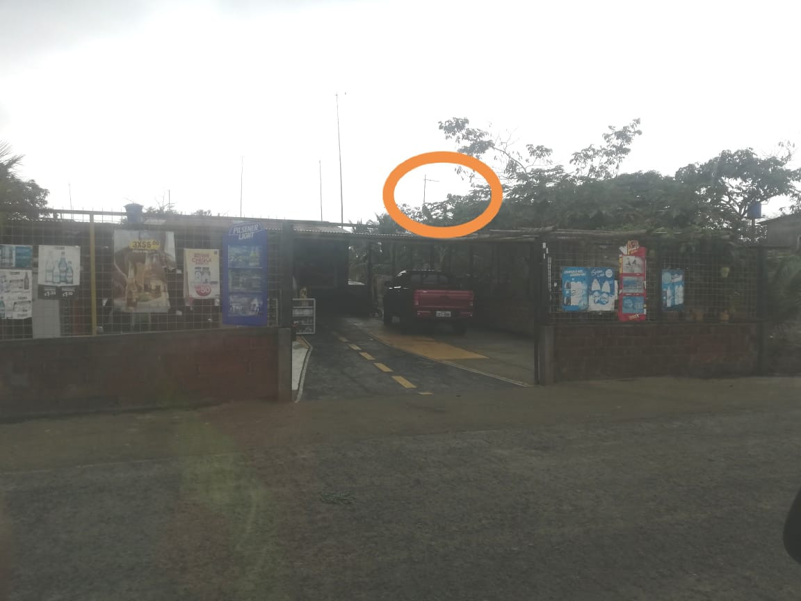

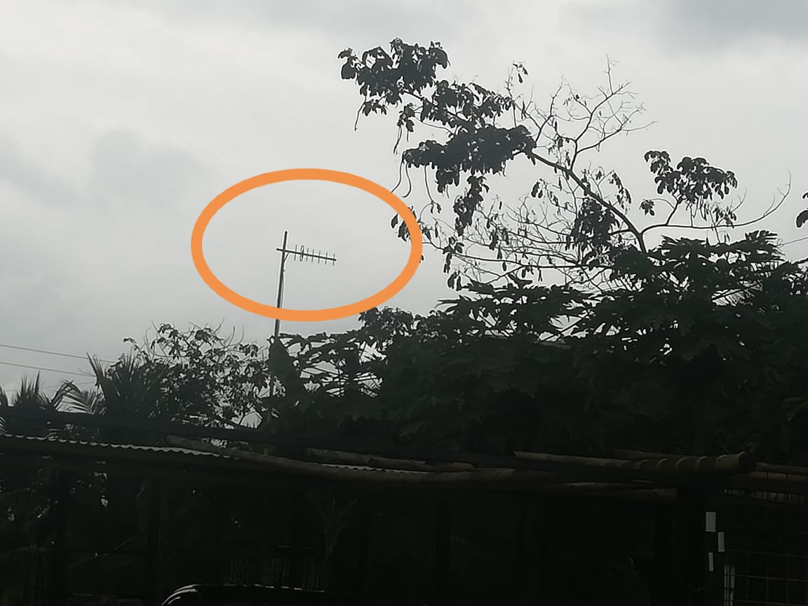

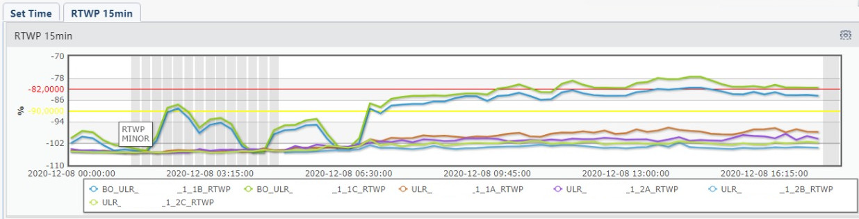

I have this problem with chinese repeater, check this picture.
Is it good practice to go up to site location (assuming rooftop), leaving the sector behind you and moving spectrum antenna around?
In picture, impact on 2 cells on same site, is it right?

This is when I find the interference…

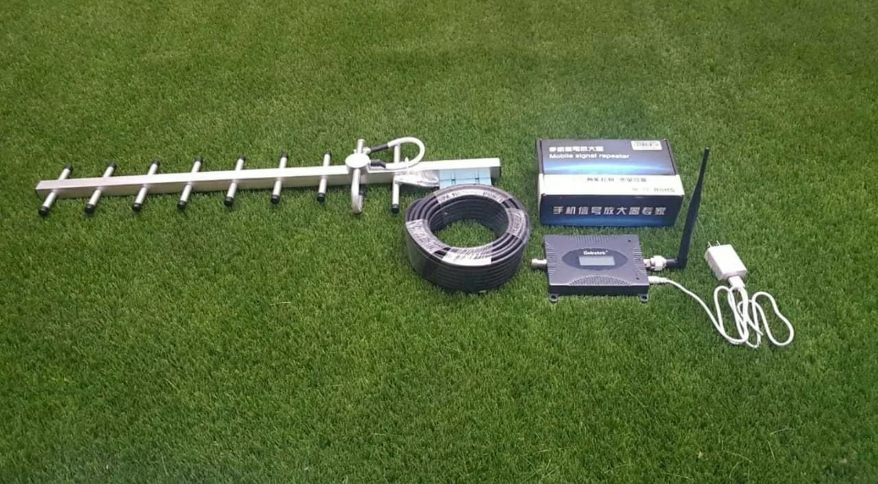

The problem was cheaper repeaters, if this people use Andrew or Comba or Cornin don’t have problem.
This equipment have price of 60 USD.

The problem is from isolation, as you can see is on one channel of 200 kHz.
Exactly what I did, but was using Anritsu Spectrum.

I am using ANRITSU MS2712E.

I solved 107 issues of high RTWP and all were cheaper repeaters.
This equipment repeat all bands from 700 to 2500 MHz.

The issue is yagi antenna of repeater.
If you change azimuth of antenna sector and RTWP reduce, then your problem is external interference.
