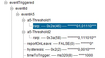

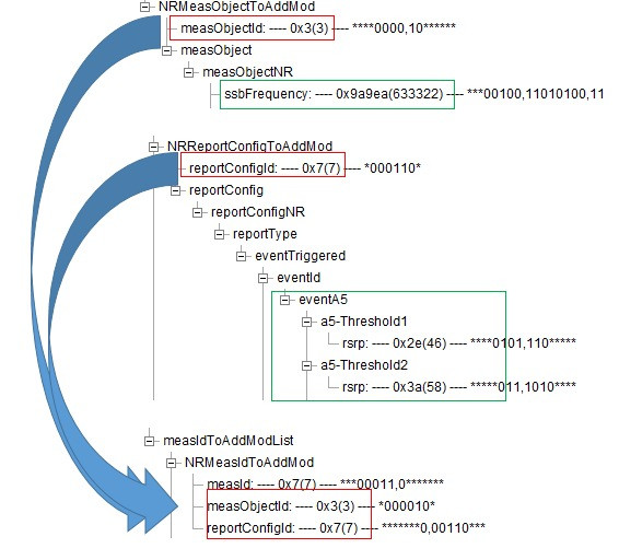

Look that now I have Event A5 (Inter-Frequency) in NR.
Look…Event A5 (Inter-Frequency) to NR78.
This event is for SCG change (release/add).
Yes correct, Spcell change not Handover.

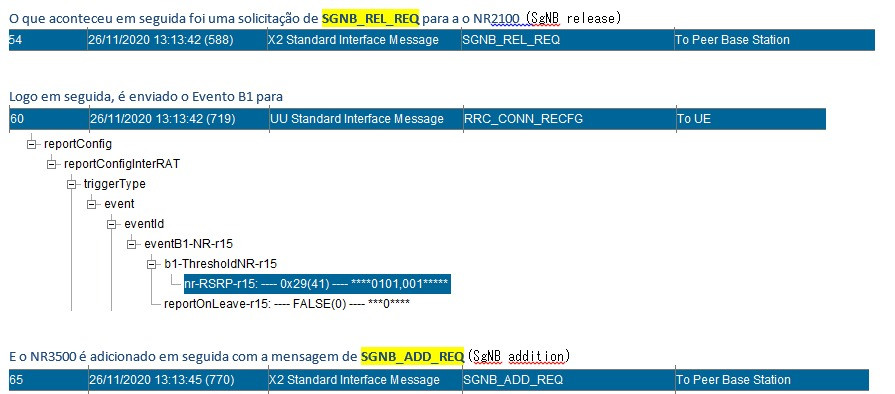

Look the msg=54.
SCG Rel to NR2100 and after msg=65, SCG Additional to NR3500.

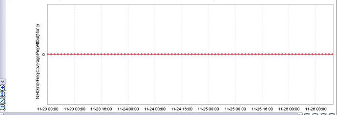

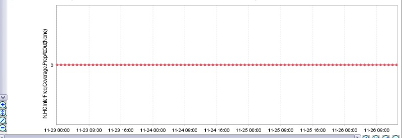

I Looked the counter and there is no HO (obviously). :slight_smile:
