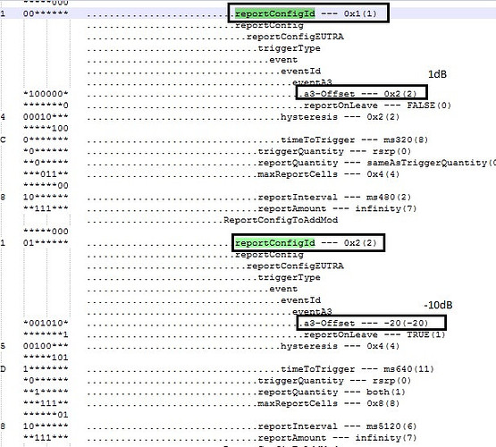

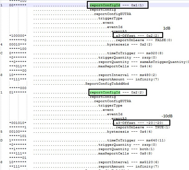

I know that these reportconfigID 1 and 2 belong to carrierFreq=XXXX because the association with measObjectId.

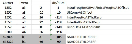

The question is: What parameters these two A3Events (1dB and -10dB) belongs?

In my opinion for -10 dB, if the NW is Huawei and UL Comp enable it could be used for UL COMP as the A3offset default value is -10 dB.
For 1 dB offset and 1 dB hysteresis it could be normal A3 for HO purpose.
OK. Great (UlCompA3Offset).

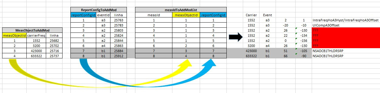

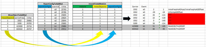

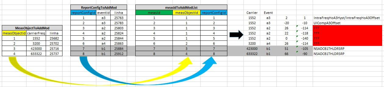

Mapping is like meas id mapped to report config id mapped to meas object id.
Will be easier to know the function if you have meas report of each id.

Check below part of log to understand better, where this report config id mapped.
I have this map.
The question is: I’ve 3 EventsA2. What parameters belongs which one?
-114 dBm / -118 dBm / -140 dBm
For -140 dBm I found (BlindHOA1A2thdRSRP).
-114 for A2 inter Freq.
-118 for wcdma.
-140 for redirection.

I didn’t found the A4…
I got (InterFreqHoA4ThdRsrp).
A4 used for condition when target is better then predefined threshold.
So it must mapped with target Freq.
