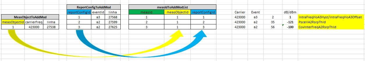

Hi @Cesar_Nunes. My check in your log.
When you use NSA mode and anchor is LTE, you can add SCG/modify/release.
There is no handover kind of thing from SCG1 and SCG2 in NSA 3X option (If some one want to add here, please add).
Once SCG-1 becomes poor (NR A2), anchor LTE can decide to release it, and then if SCG-2 NR cell 2 is better (NR B1), then can decide to add it.
Ok, but it is not Handover.
First is a SCG release and after is SCG add, am I correct?
Yes, correct.
And to summarize, there is no handover possible between n1 and n78 from your logs.

I still have a question: Look in my msg that the NB sent two events a2: One to PSCell removal and other to Inter-Freq coverage. My question is still: My UE supports or not Inter-Freq coverage to NSA?

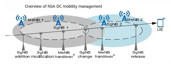

It was said that in NSA there is no Handover but according this picture from Huawei: SgNB Change : If an inter-SgNB PSCell change is required, the target PSCell can be an intra- or inter-frequency cell of a neighboring base station.
It’s possible for NSA.
Both intra and inter freq.

You can call it HO from pscell 1 to pscell 2 which can be intra or inter Freq.
It can be intra gnb or inter gnb.

There is no handover technically in 5G SCG all HO happens in Menb and nit gnb.
Only scg addition and release similar to CA scell addition and release in LTE.
