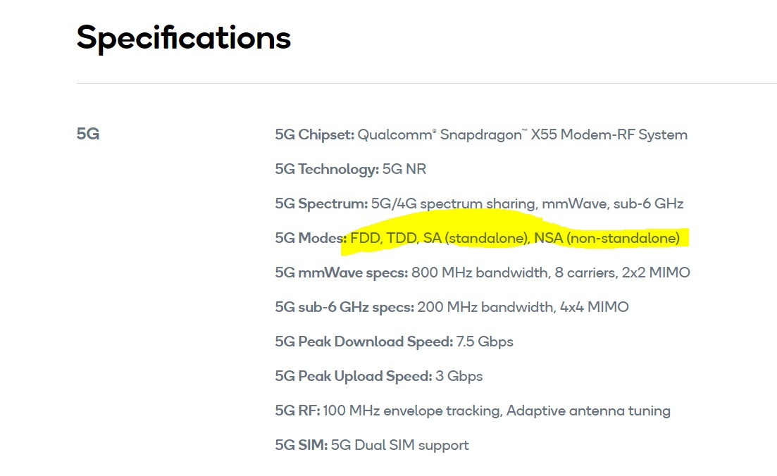

That’s true…but Google is alive. :joy:
Only if was giving specs development board! :innocent:

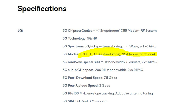

Haha, See here this is the specs for the device I use - Samsung Galaxy S20+ with Qualcomm X 55 5G modem.
True.
But the dev board caps seems to be quite dynamic!
So I need to be sure if what the device is currently reporting.
