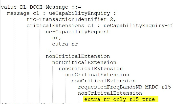

I was looking into the below UE cap msg from NSA device:
I think eutra-nr-only -r15 true means n/w support only NSA?

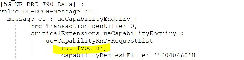

I’m inclined to look into UE cap request message from SA n/w to NSA only device.
UE capability request will be only for NR in SA.
In NSA UE capability request will be 2 of them:
One for 4G, 3G, 2G capability;
And one for eutra-nr and NR.

So if my NSA device receives a UE cap request, will I be able to identify the SA presence?
I think if that msg don’t have eutra-nr but have only NR in it, then it can be SA n/w, right?
