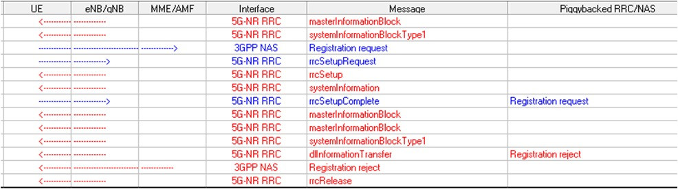

NSA Device to identify SA deployed in some areas
Yes correct, we have received the SIB1 even though there was no SA network in that area.
Still I’m not sure why the device didn’t latch to NSA.
There is some Operator specfic config which allows the device to be in SA if LTE coverage goes below a threshold…Any idea about which parameter this can be and how to get that threshold from Ue logs -may be an RSRP threshold.
