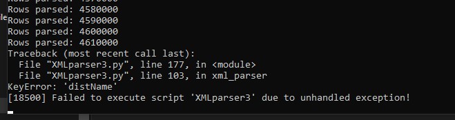

Hi,
I tried to use the parser tool (method 1 - drag XML file & drop over .exe) with 5G XML export file (~120MB) but at the end the tool return an error:
xml_parser_error
KeyError: ‘distName’ leading to unhandled exception
Do you have any idea why is this happening?
Forgot to add:
ALL_MO is used in managedObject.txt

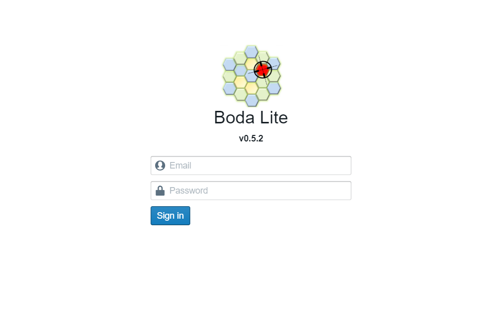

Hi Rafael,
it is need an email and password, i try to use the mail and password used to access telecomhall but i failed is any way to sign-out.
Simply read. The instructions (and credentials!) are there, where you downloaded.
