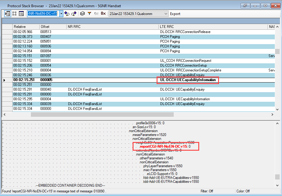

I have removed all NR neighbors of LTE site and enabled ANR with 5G NSA to inspect inter-RAT ANR mechanism between LTE and 5G NSA. based on UE DT logs, when enodeB instructs UE to report nCGI of the missing 5G neighbor, UE does not send the nCGI and keeps reporting measurements of the same NR cell until enodeB adds another SCG which is already included in neighbor cell list of LTE (there are other 5G UEs in the network and all of them can be responsible for this neighbor addition)
The only reasonable explanation is that test UE does not support NR cgi reporting. I looked into UE capability information message and only found reportCGI-NR-NoEN-DC-r15: 0
There is no sign of reportCGI-NR-EN-DC-r15 which is for NSA-DC networks. What does it mean? can experts please support?
reportCGI-NR-NoEN-DC-r15 is the required capability for ANR
I wonder why: enb know about UE capability, not support cgi reading, enb should not instruct UE to read cgi of missing cell.
