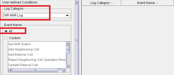

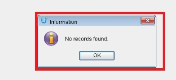

I’ve enable ANR in NSA 5G here but we didn’t see any action from ANR in SON LOG (U2020).
Does ANR 5G NSA works?
Vendor is Huawei, RAN16.0

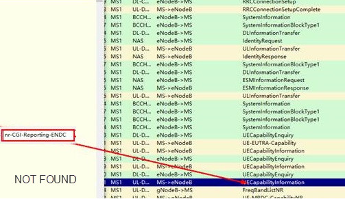

For the NSA ANR support or not, we can check IE nr-CGIReporting-ENDC in the UECapabilityInformation Message.
In NSA networking, intra-RAT ANR requires that UEs support neighboring NG-RAN cell measurements of report type reportCGI (nr-CGI-Reporting-ENDC) in E-UTRA-NR Dual Connectivity (EN-DC).
So, if in the LOG there’s no “nr-CGIReporting-ENDC” IE in the UECapabilityInformation Message, so UE do not support it.
The problem is UE or NSA?
Is NSA and UE.
First UE does not support CGI reporting and second NSA does not transmit SIB1 with CGI.
Even if you would have an SA network with CGI in SIB1 it wouldn’t work since your UE does not support CGI reporting.
