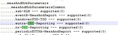

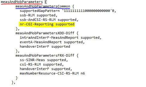

Ask them to check under measAndMobParametersCommon, there you will find it.
If its supported.

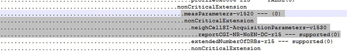

I checked one UE log but my UE supports only nr-cgi-reporting not EN-DC.
Asked my team to check other UE Logs.
If found, i will update.

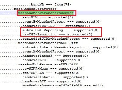

Same in my phone:

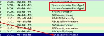

Look, we have SIB1 in this log.
This sib1 is for serving cell, not for neighbor cell.
UE cannot read anything in NSA from new cell before RRC connection reconfiguration.
And its LTE SIB1 LTE-RRC, right? Not NR-RRC.
It’s LTE sib1.

Now you need UE that supports nr-cgi-reporting-endc.

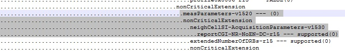

I have enabled the SIB1 and make a test using Motorola Edge 5G but appears only “reportCGI-NR-NoEN-DC-r15”.
As I understood the problem is from UE.
The terminal capabilities are not supported.
No mobile phone model currenlty supports ANR under NSA networking.
There are only 3 terminals know in SA networking: P40/pro, Honor v30, CPE Pro.
In a short time, there’s no precondition for using ANR. [ Base station capabilty support [Y], UE capability support [N] ].
To use this fucntion it is needed a mobile phone with a higher version protocol as a prerequisite.
