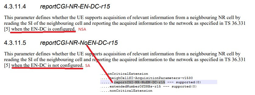

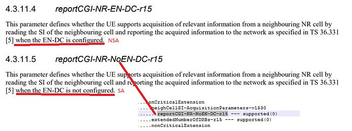

In other UE (Motorola Edge) I found it:
... reportCGI-NR-NoEN-DC-r15 --- supported (0)
But it´s not the same.
You said “eutra-cgi-reporting-endc-r15”.
I found “eutra-cgi-reporting”.
In specs it’s showing endc-cgi-reporting-endc-r15.
