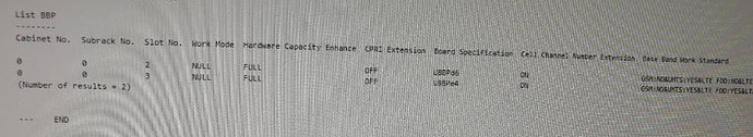

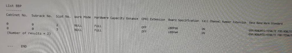

All Cells are in the same board?

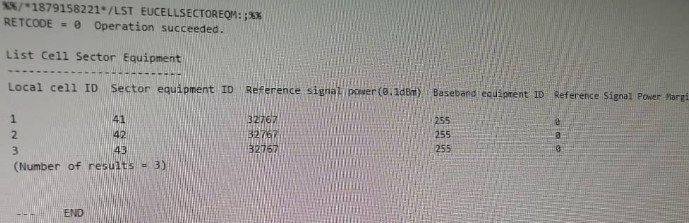

Run this command: LST EUCELLSECTOREQM:;
Other thing: Do you know which board model the eNB are using? UMPT?
All sectors are OK.
Yes, it´s OK.

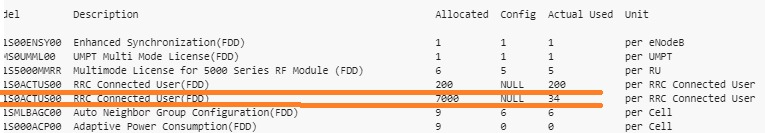

It supports up to 3600 UEs in RRC Connected Mode in 20 MHz.
Also make sure to chk globalprocswitch for sync user.
I think that you need to ask Huawei to add more License. (Of course you will have to pay for that)
Huawei default RRC license is always low.
Look my cases here…
Thanks @Cesar_Nunes, I see.
And of course, we need to contact Sales dept, for license expansion.
