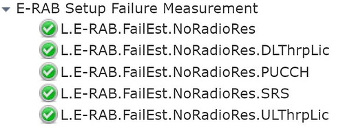

Well I double checked PRS and only those are available.
The counters could be not activated
Will check on that.
But knowing the exact issue (SRS, PUCCH, DL or UL lic) will not solve the issue.

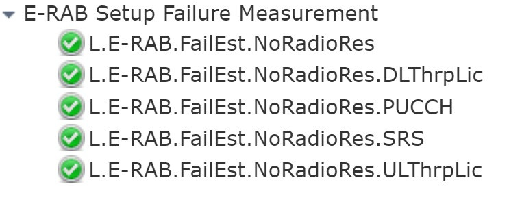

The main failure is L.E-RAB.FAILEST.NORADIORES.
But there is one subcounter for license issue is not active.
Just activated it and will keep monitoring it.

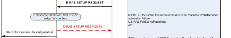

No, for eNB it is a RAB phase.
The MME send the E-Rab Setup Request and there is no Resource at eNB Level and it return fail to MME.
First UE needs an RRC connection.
After RRC is established then ERAB is established.
In his case most of UEs fail at RRC estab so such UEs do not reach RAB estab phase.
