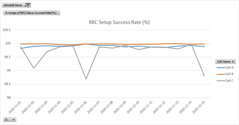

This is the trend of RRC.
RRC Setup Sucess Rate (%)

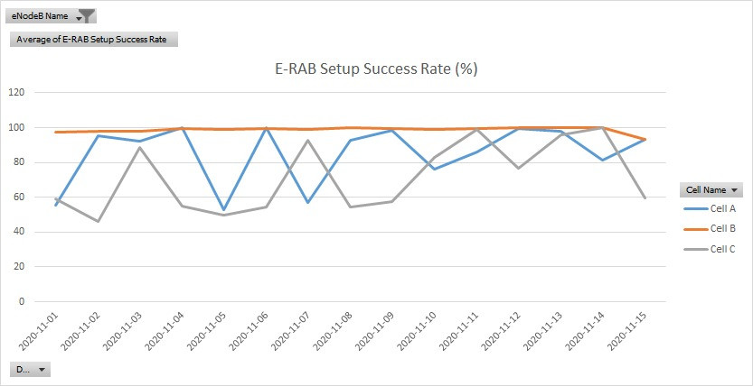

And E-RAB for the same period.
E-RAB Setup Sucess Rate (%)
Ok Cell C and Cell A eRAB KPI is reversed of 14 and 15.
Even Cell B is degraded, as compared to 14.
Yep, may that’s returned us to my original question: since the failures are mostly caused by lack of RRC User License (actual values exceeds the allocated ones) and since the license is distributed on eNodeB level, not cell level (or that’s how I understands), why certain cells get impacted rather than others?

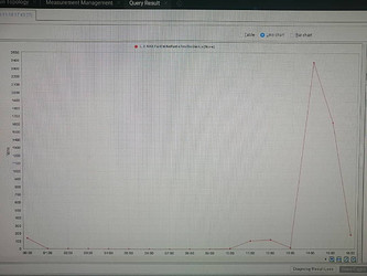

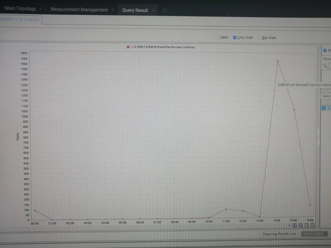

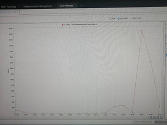

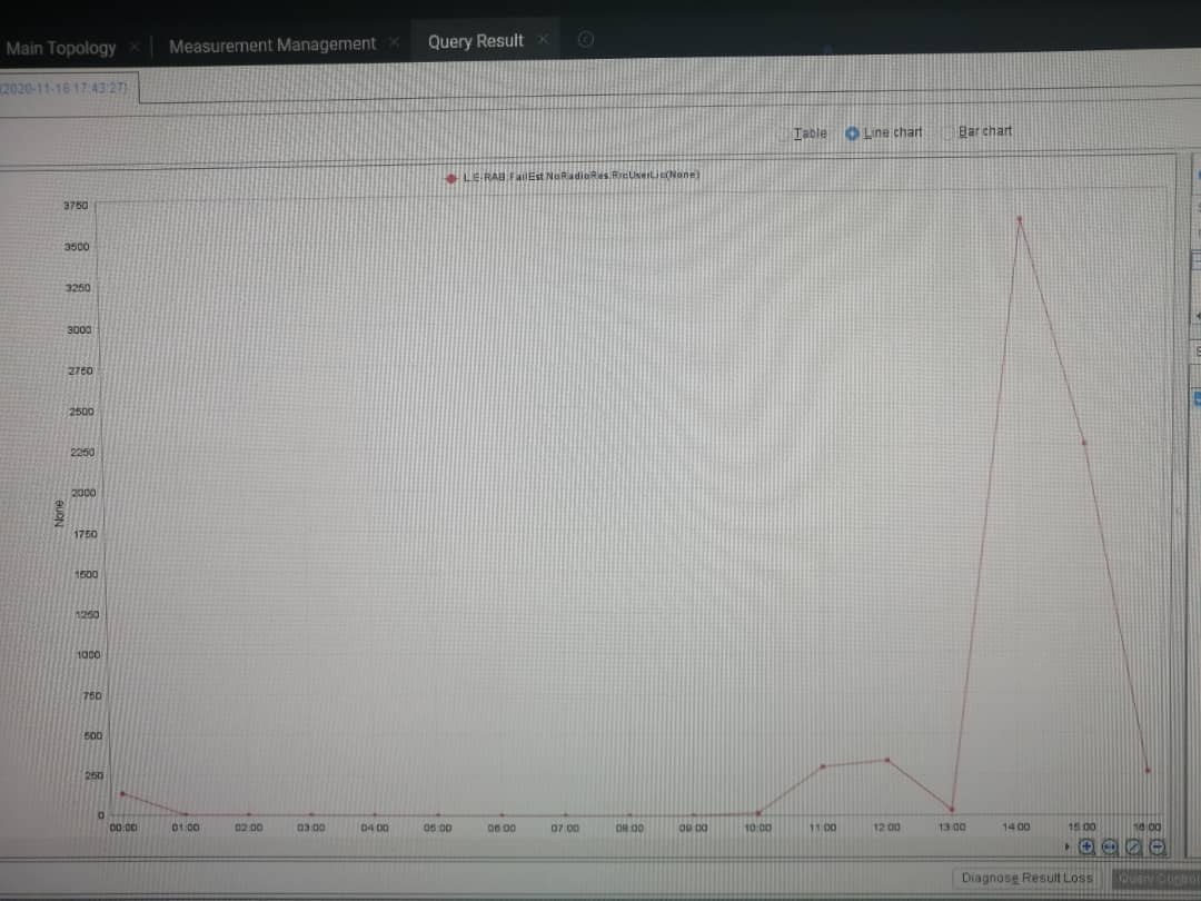

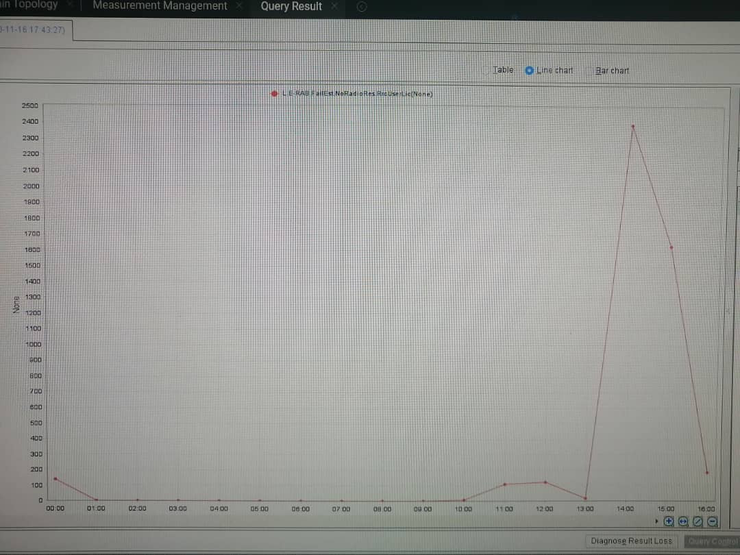

Btw, these are measurements of L.E-RAB.FailEst.NoRadioRes.RRCUserLic for the three cells
Hourly, for today.
So it reversed.
It’s lot of failures after 13 h.
License is the thing, the solution.

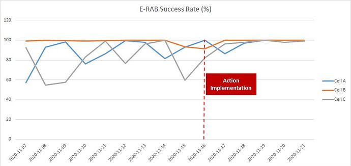

Thanks @Pirm, I did reduce the 4G cell radius using E-tilt and worked on pushing more some of the traffic to 3G, will consider A4 event as well.
And thanks all the others too, for example about UE inactivity reduction.
Thanks for the contribution!
Hello dears, Update:
As menitoned, I had a degradation in E-RAB Success Rate due to L.E-RAB.NoRadioRes.
After some actions (E-RAB improved from avg 40% to 70-80%), I decreased UE Inactivity timer from 5s to 2s.
Good results have been achieved as shown below:
Using MOD QCIPARA, I decreased all QCIs to 2 s except for QCI 69, which I made it only 3s
I decided to make QCI 69 to be 3 s.
Other QCIs values are 2/3 of QCI 69.
Thanks guys for the help!

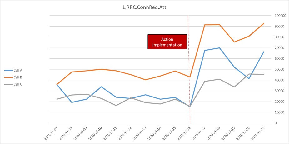

But user experience is affected. How about no of counter erab setup failure?
Any idea how to check amount of signaling in LTE?
Is RRC Requests a reliable measure?
Yes, it is.
Significant increase in signaling.
But it’s ok as long as you don’t get RRC failures.
