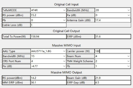

Where does these calculated 35.2 dBm come from?
Maximum Transmit power is different than EIRP power.
I know, but I would like to see the calculation, where does it come from?
Maybe my RS is wrong? (9.7dbm)
Can you modify your RS power to 14.2?

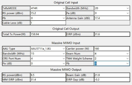

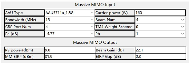

In your plan could you simulate Pa = -4.77, Pb = 1 and RS = 9.7dBm?

And my setting is RS 11.3 and Pb = 1 and Pa = -6 dBm.
Since I need coverage so reduce Pa to -6.

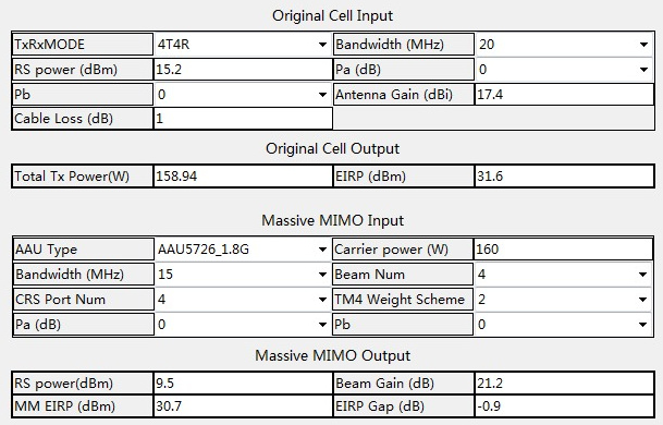

With these settings you have RS power = 9.5 dBm:
One question please: why you are affraid to increase RS power?
From 9.7 to real value 14.2 to achieve 160 Watts?

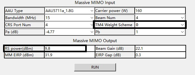

Guys, the TM4 is 0:
It should be 2 or 4, not 0.
It has values only 0, 1 or 2.
Can not set to 4.
TM4 weight scheme 0 corresponds to Default Mode.
Default mode= cellbeamtilt is valid and can be adjusted.
Yes, I’m using default Mode = 0.
