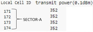

Today I have 35.2dBm (3.31W) per cell (1 sector).

This is Maximum Transmit Power (0.1dBm) = 35.2 dBm.
