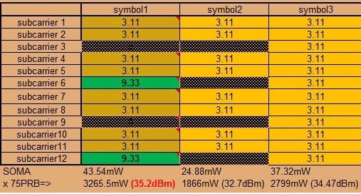

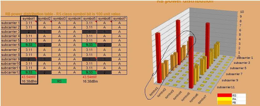

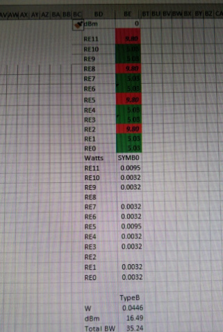

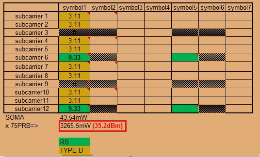

Symbols with RS (typeB) you will have two REs with 9.8 dBm, two more with nothing (other antenna ports), and the remaining with 5.03 dBm (9.8-4.77), when you sum them all, you get 16.49 dBm per PRB. Multiply by 75 PRBs for your total BW, you will get the 35.24 dBm.

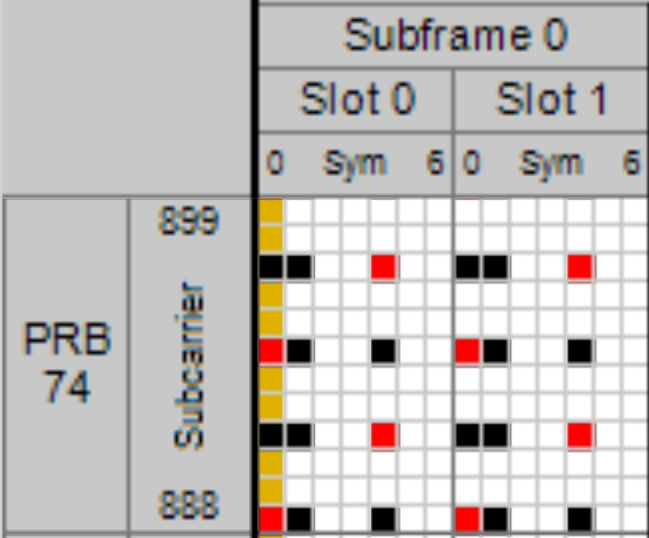

What is RE0, RE1, Type B?
In one PRB I have 4 RS (type B), correct?
Red means RS (TypeB).

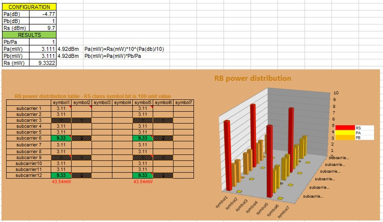

Pa (mW) = Rs * 10 ^ (Pa / 10) and Pb (mW) = Pa (mW) * Pb / Pa
Pa = 3.16 mW = 4.99 dBm
Pb = 9.5 mW = 9.8 dBm
Pb is RE that cointan RS

@marcengo, why are you considering only the symbol 1?
In PRB I have 4 (RS) and 8 (TypeB), am I correct?
Why are you considering only RS and TypeB in symbol 1?
My case was 2T, yours is correct.
For 4T, symb1 also carries REs for CRS.
It’s correct.
For the power we use 1 symbol.
Thanks @marcengo
I need to consider the MAXIMUM transmitted in one symbol. In my case, 35.2dBm.
