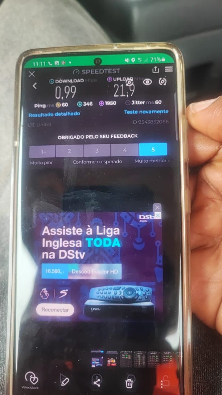

I have one sector in LTE site with UL Throughput greater than DLThroughput.
Anyone have the same issue?
Vendor Huawei
Hello Experts,
Vendor Huawei

I have a site where the Upload throughput is greater than the Download throughput.
Is there any explanation for this type of event? How can I resolve this, if it is a problem?
