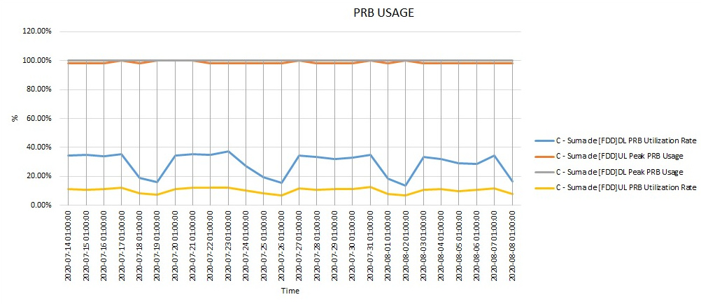

Second check PRB utilization, CA, Ranking Indicator, number of simultaneous users…

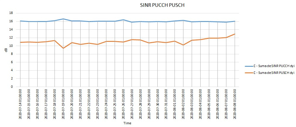

Even the SINR is bad.

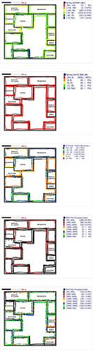

These are drive test results.

You should start investigating why SINR is so poor.

Some Charts…

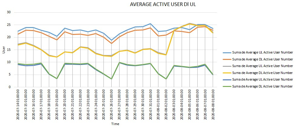

Average Active User DL UL:

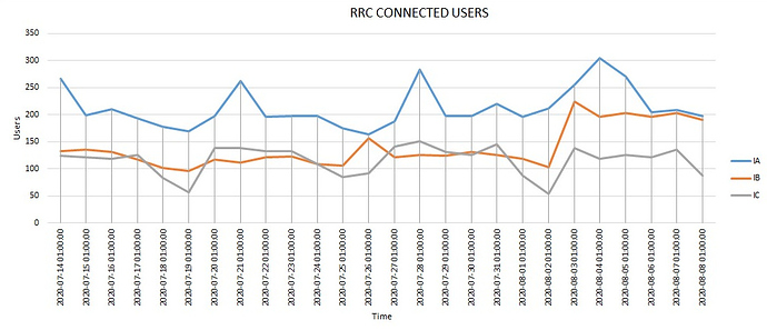

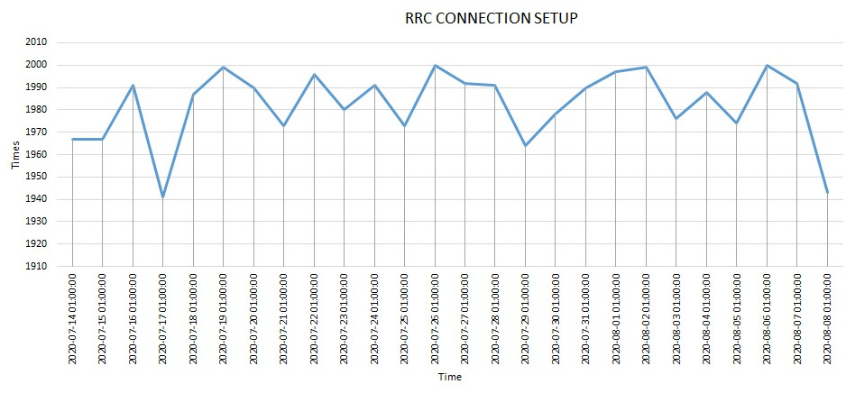

RRC Connected Users:

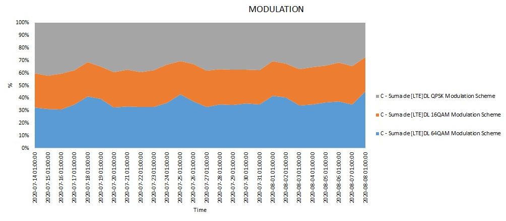

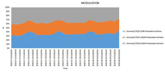

Modulation Usage:

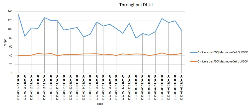

Throughput DL UL:

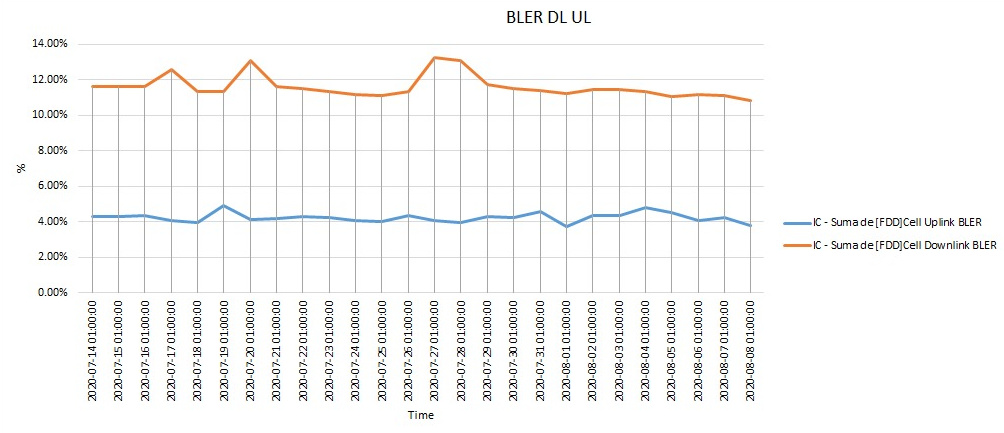

BLER DL UL:

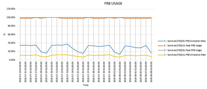

PRB Usage:

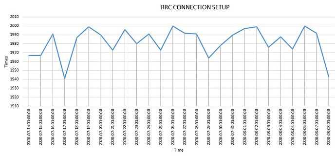

You have to observe the Success also.
Check why SINR is poor.

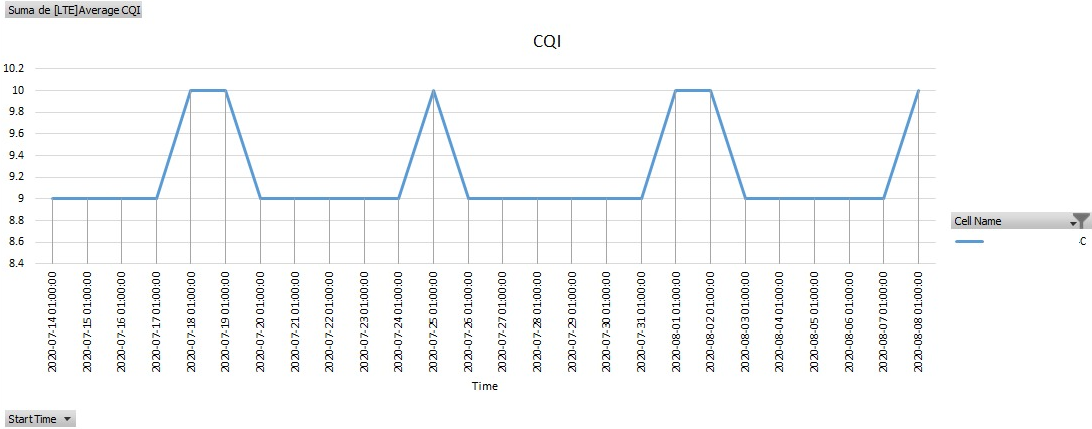

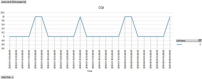

What’s the CQI value?

I have never seen such a bad sinr with such a good rsrp.
Possible explanations: too much overlaping with other cells, external interference, wrong power settings, etc…
Maybe something wrong in software/legends.
Not related to RF absolutely.
Even you are getting good tp with such SINR.
With current SINR, you should get up to 3 Mbps only.

Also the CQI map.

Can you please check Cell Throughput in DL, not User Throughput?
