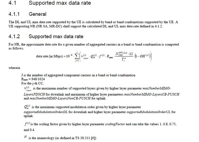

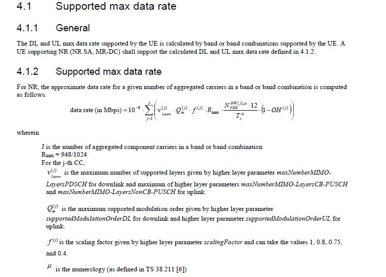

As mentioned for NR max data rate:
I know formula.
I am just interested in limiting factors apart from that page.
Like the ones I mentioned above.
