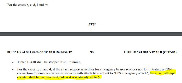

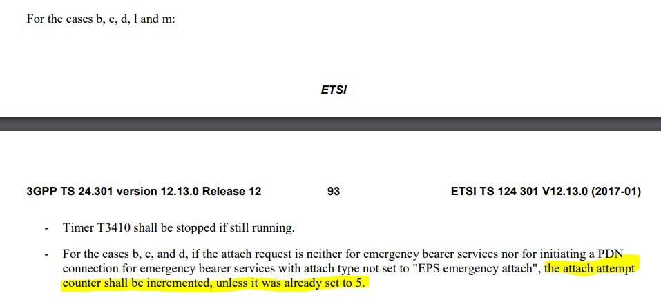

While @ran_core_consultant comes back, please check these references from 24.301.
Basically, attach attempt counter can be incremented for cases b,c,d,l & m.
Here, lower layer failure means being unable to send attach request due to RACH failure.

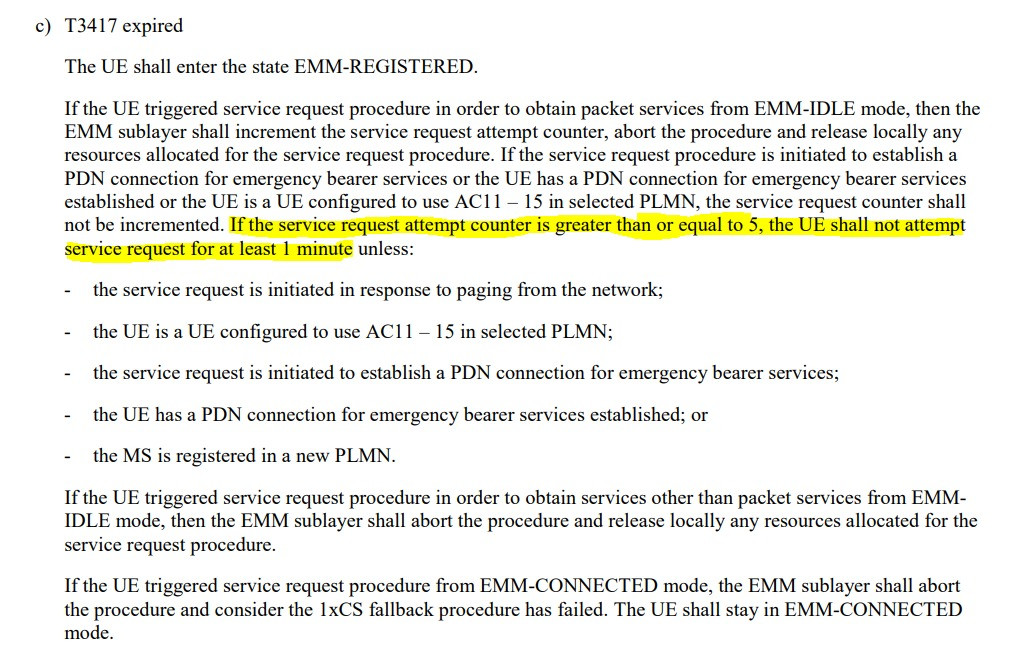

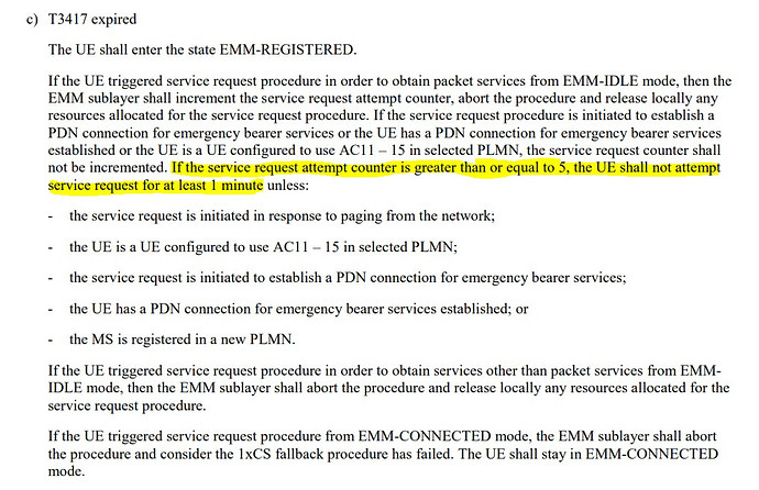

If it is for service request, I think T3417 expiry comes into picture.
A separate counter called “service request attempt counter” comes into picture.
After this count exhausts, UE needs to back off for 1min+ time. No PLMN blocking.
So UE will not send service request on any cell for 1 min, right?
Which spec is this?
Same 24.301.
Please check the exceptions too for the same behaviour in the snippet.

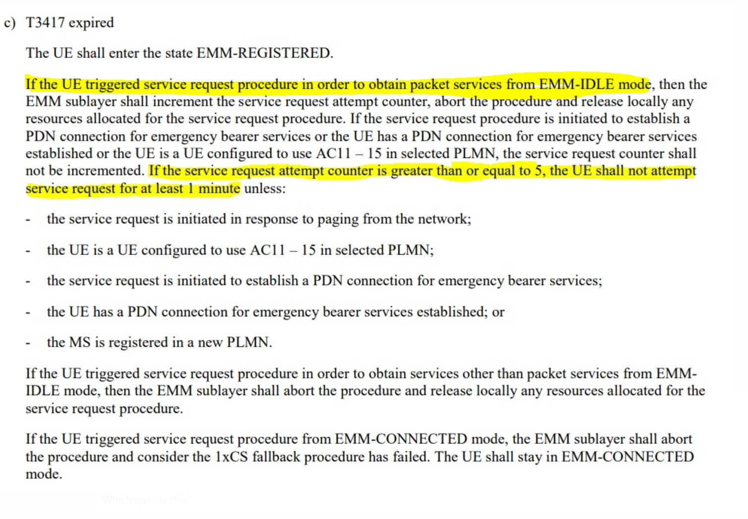

How about T3417?
Is it related to rach for ordinary ps services?
To me it looks it is also for EMM idle state.
Because it is only for EMM-Idle state:

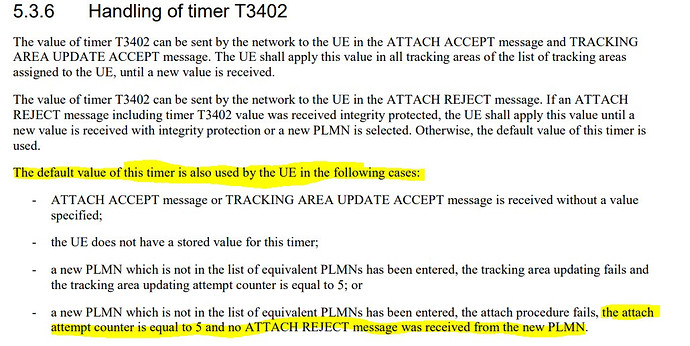

T3402 starts when attach attempt counter at NAS exhausts (max 5).
If you agree, can you take a look at the NAS spec ref I pasted and why it doesn’t make sense?
MSG1 sending failure comes into this category:
Ref for T3402 and attach attempt counter:
