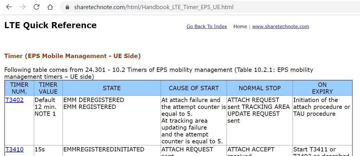

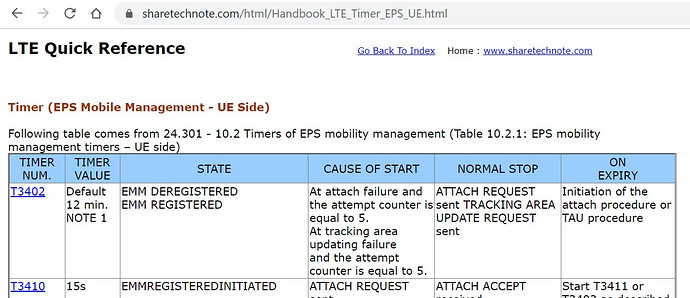

Again, with @Jaeku_Ryu help (ShareTechNote):
https://www.sharetechnote.com/html/Handbook_LTE_Timer_EPS_UE.html
T3402 start at attach failure not at RACH failure

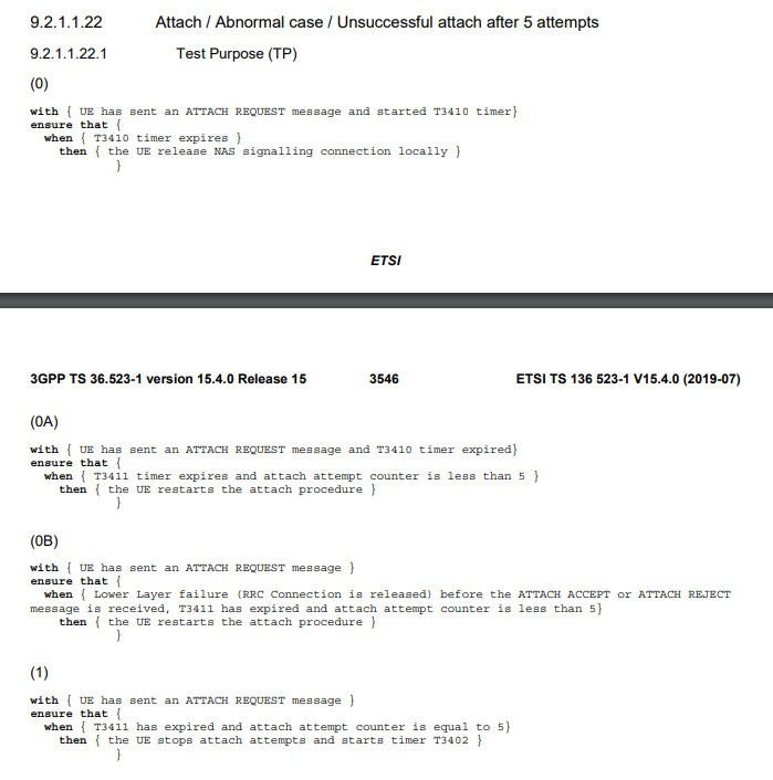

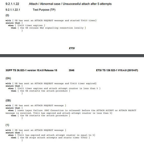

This is not just my understanding, but some operators have the conformance TCs to test this behavior.

According to the specs: T3402 is started when 5 attach request were sent by UE.
Sent means Ue managed to send attach request at NAS layer, not the RACH procedure.
@ran_core_consultant maybe you can better explain what is T3402 and the fact that it has nothing to do with RACH procedure.
Sent actually means “Sent by the NAS layer to the lower layers”. Doesn’t have to be OTA.
I hope this would give some more intuition : 4G | ShareTechnote
Actually it says attach failure.
That means attach request was sent and answer received.
Attach reject or failure.
T3402 actually stops when attach request (rrcsetup complete, msg5) is sent by UE.
T3402 starts when: At attach failure and the attempt counter is equal to 5.
