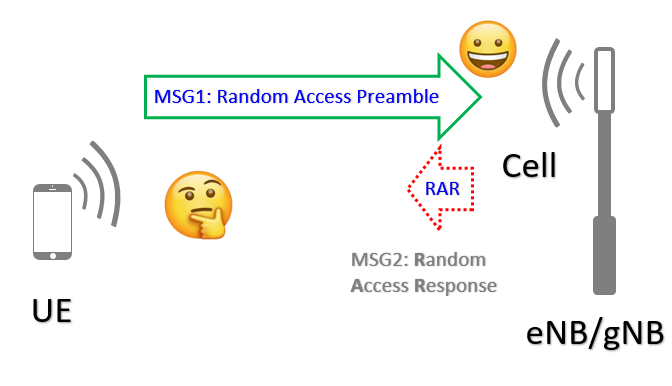

If there is no RAR response from eNB/gNB will UE keep sending msg1 till preambleTransMax?
During RACH, if there is no RAR response from eNB/gNB, then will UE keep sending msg1 till preambleTransMax?
If preambleTransMax has reached, then random access failure is reported to higher layer. If this is keep on happning many times, what is behaviour of UE/higher layers?
Will UE stay on that cell only and keep attempting RACH or can it select/reselect new cell for RACH?

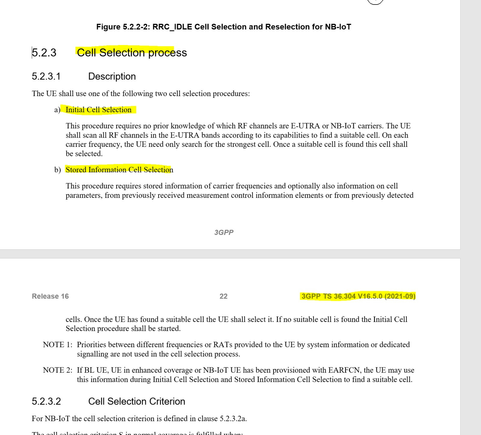

Do you mean how many rach failure there can be before UE goes to idle?
It performs reselection (not selection) after rach failure.
This part I want to explore.
Any spec which says this?
Cell selection happens only at power on and coming from no coverage (PLMN search).
Some details here: LTE UE cell selection | LTE UE cell reselection
Quote:What happens when lower layers sends RACH problem indication?
When upper layers receives RACH problem indication, UE will re-try to camp on to the same cell, while parallel doing PLMN search to find any other alternative cells.
