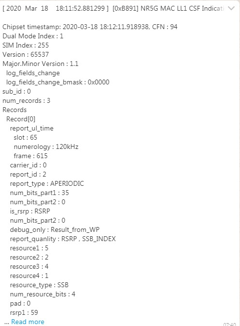

Whether csi beams or ssb beams are used for beam switching it is based on reportquantity IE inside RRC Connection reconfiguration.
UE may or may not be informed about beam switching.
I searched inside logs and found reportquantity for an example like CRI-RI-PMI-CQI so in this case it is based on CSI resource indicator.
It’s part of beam measurement and reporting.

I think any PCI-SSBid combination will be used for both cases ie within same cell or different cell with different PCI.

UE measures them and report 4 strongest beams among all possible 64 beams, for example.
