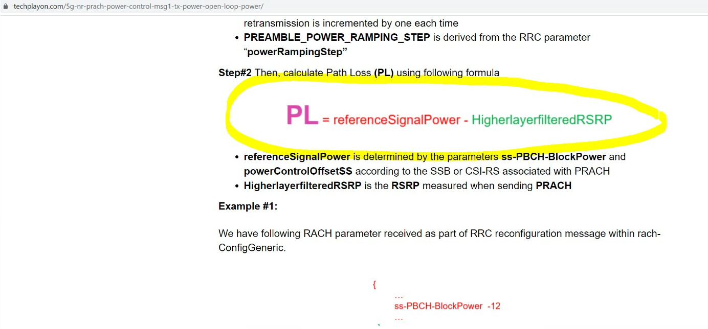

It is ss-PBCH-BlockPower minus SSB-RSRP.
Hmm… can we see in UE logs?
I mean, any parameter readily available?
As in @Tech_Playon post: 5G NR PRACH Power Control: Open Loop Power
ss-PBCH-BlockPower is a parameter.
SSB RSRP is a measurement.
Look at UE Tx power and you will realize if excellent, medium, poor or bad coverage.
