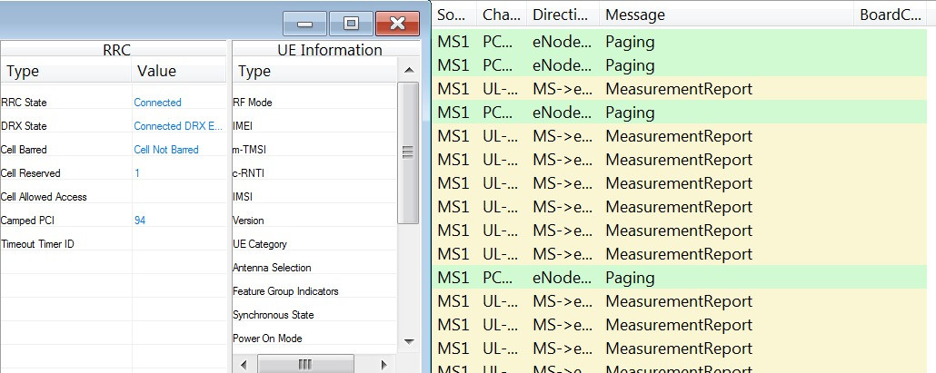

Anyone can explain why in RRC-connected mode, UE still receive paging messages?
It’s seen always in live networks, many times.

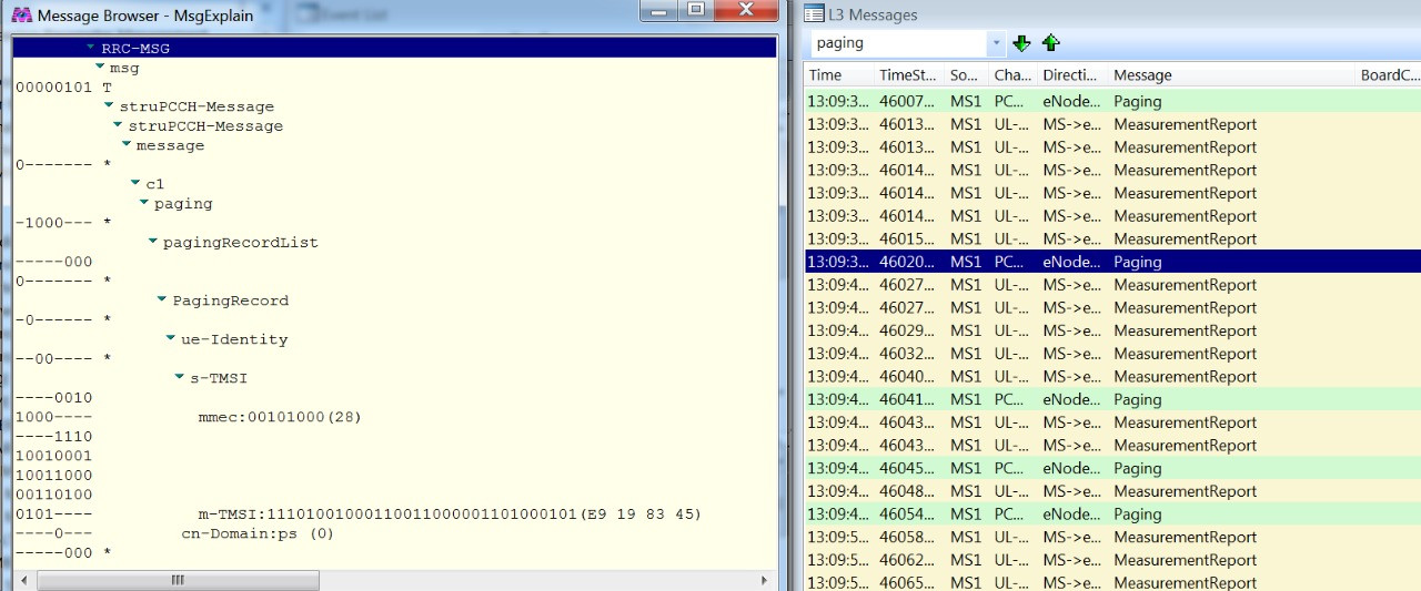

This is normal paging:
Without SIB modification and etws, as well seen.
I even seen same.
In LTE UE has to get the Paging through PCCH regardless of whether it is in Idle mode or Connected mode.
Therefore, in case of LTE monitoring timing of Paging need to be considered even in the connected mode.

Paging message what you shown I even seen many times in connected mode but still I didn’t have idea what need of these paging message…

This is needed for another UE, but this UE in connected mode still has to read/decode paging.
Yes, increasing delay.
Paging msg is is broadcast message. Sent to the group of UEs and it is scheduled of fix DL RBs.
So even if it is not intended for particular UE, it has to read that paging and confirm if it is for that UE or not.
You can see UE identity here.

Because paging of another UE.
This UE only read/decode PCCH.
