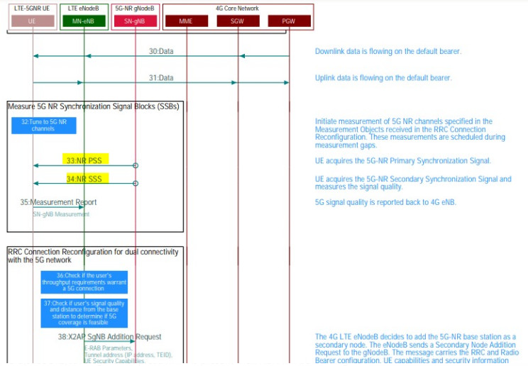

They camp on LTE and add SCG for 5 NR not SA capable UEs won’t find PSS/SSS while scanning raster.

So all necesary information of SA will be delivered to UE via LTE.

For acquisition purposes, on an NSA carrier no RRC from there.

My query is what NSA UE will do if there on only SA coverage.

Nothing. Stays in LTE.
