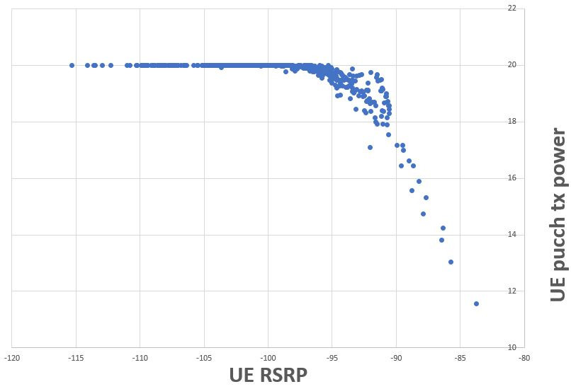

According to drive test data, as soon as the SSB RSRP is lower than -98 dBm the UE PUCCH power reaches 20 dBm and there are plenty of RLF (due to maxtxretransmission reached) and SCG failure addition.
Please see graph:

Any reason why PUCCH power is restricted to 20 dBm only?

If your device is class 3, network must have restricted UE MAX TX power by configuring 20 dBm max value.
PUSCH is also capped at 20 dBm all over the drivetest.
Yes. In NSA you can not go beyond 20 dBm unless UE support TDM or Dynamic power.

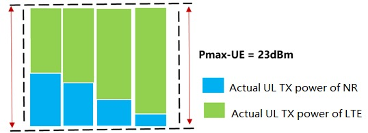

Max power =23 dBm.
So NR set Max 20 dBm and LTE set 20 dBm.
If UE support dynamic power sharing, UE can have higher power in any of LTE or NR by maintaining total 23 dBm power.
