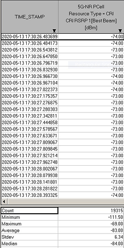

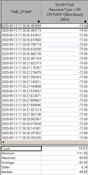

I dont see a specific periodicity in one sample log for CSI-RSRP.
Maybe it’s aperiodic.

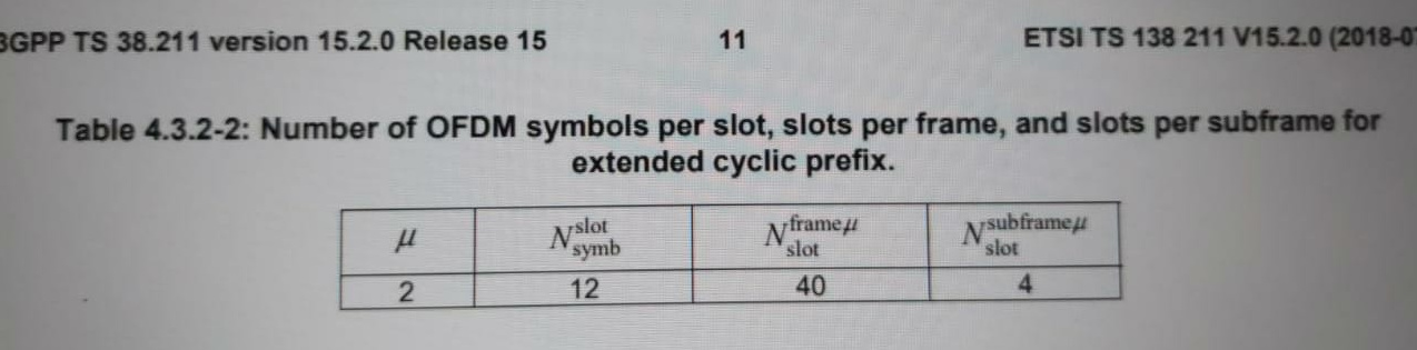

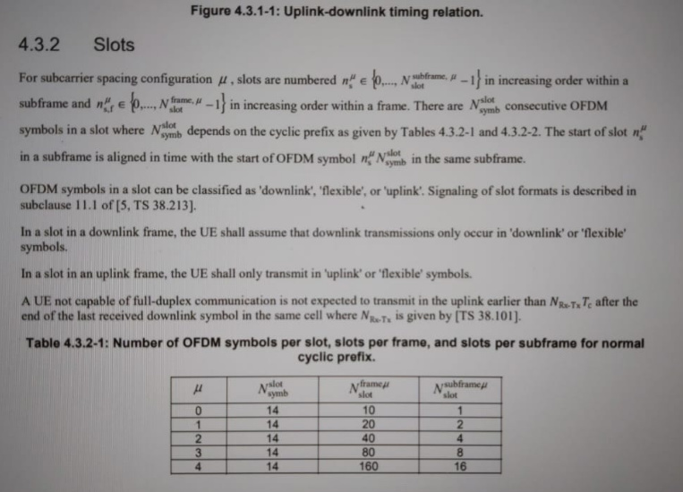

In TS 38.211, the slot is the part of the frame, as per the definition.
Th number of slots per subframe depends on numerology.
Please note user scheduling in 5G is per slot like in LTE per TTI.
Slot 0.5 ms for 30 Khz.

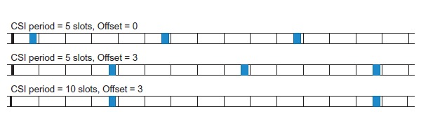

Here you have an example:
However, periodicity of CSI-RS can be periodic, Semi periodic and aperiodic also.
In the case of aperiodic CSI-RS, no periodicity is configured. Rather, a device is explicitly informed (“triggered”) about each CSI-RS transmission instant by means of signaling in the DCI.
