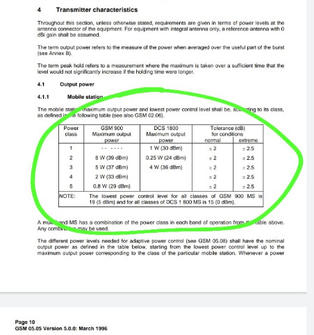

Hi Experts,
What is the max power GSM UE can radiate?
I think typical 2W =33 dBm but some class A can have more than that.
As per standard:
Yes in Nokia TXP1 parameter is there to increase power to 39 dBm.
But surprisingly for GSM900 is having higher than 1800?
Ideally 1800 should support higher than 900.

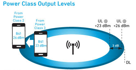

In LTE HPUE class 2 supports higher 26dBm for B41 which is logical.
How to check current latest mobile GSM UE power class?
No 1800 has higher penetration loss than 900 so if DL parhloss high then accordingly UL parhloss to be maintained.
That is from 21 dBm to 26 dBm.
Same logic between FDD and TDD but we have Class 2 UE in B41 (higher band) not in lower bands.

UE power should be higher in higher bands for eg. in LTE B41 supports class 2 26 dBm while FDD (lower band) supports class 3 (23dBm).
When there is no GSM 900 only GSM 1800 and GSM UE should support higher power so that cell radius can be higher.
Similar to LTE TDD HPUE feature.
For same reason GSM 1800 UE power should support higher power than GSM 900

So, UE 900 power should be higher than 1800.
That’s the question.
