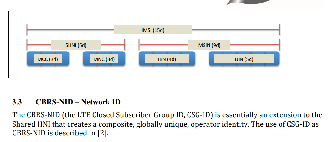

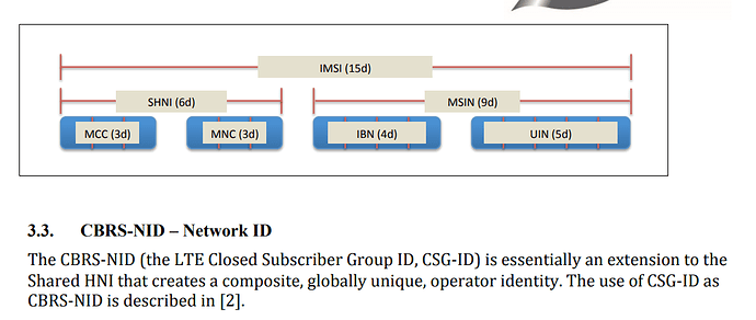

Assuming you already look through closed subscriber group,
I am not 100% certain, but how CBRS control the access for multiple network could be scenarios to benchmark.
I think it’s common CBRS scenario limiting PLMN access based on tracking area.
I’m not totally aware of how the CSG works but as far as I could understand it creates a group of cells accessible only for specific users. Am I right? If so, I guess it’s not feasable in a wide network since it implies that you should have duplicated cells depending on the type of user that tries to connect.
