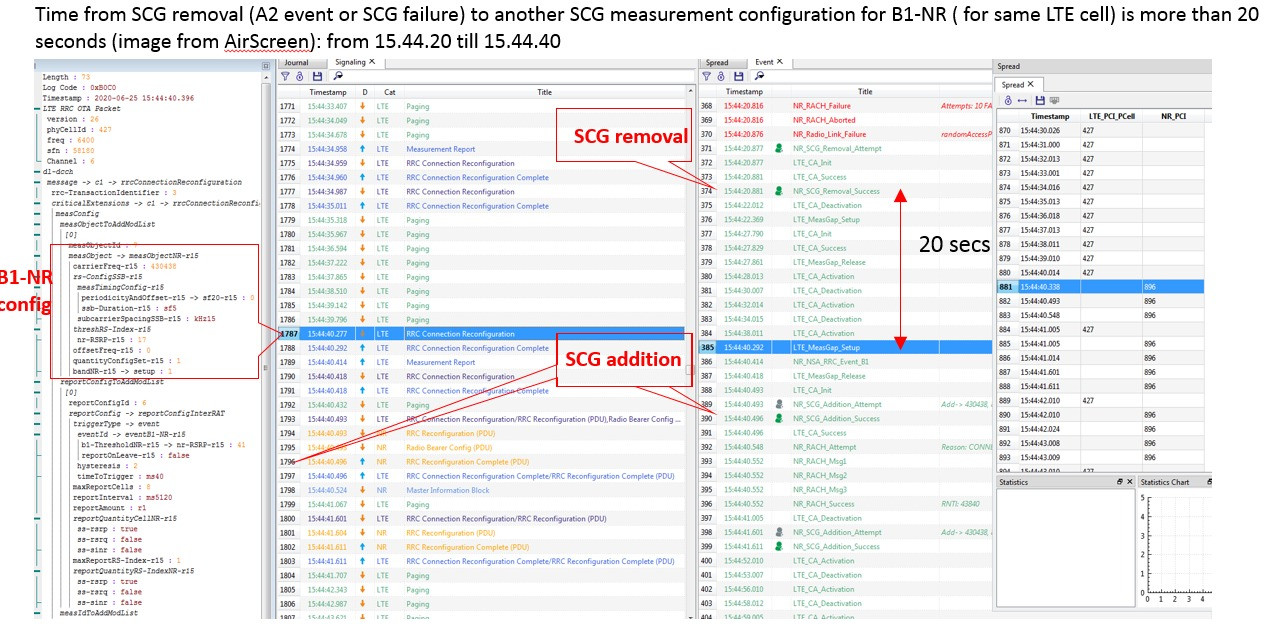

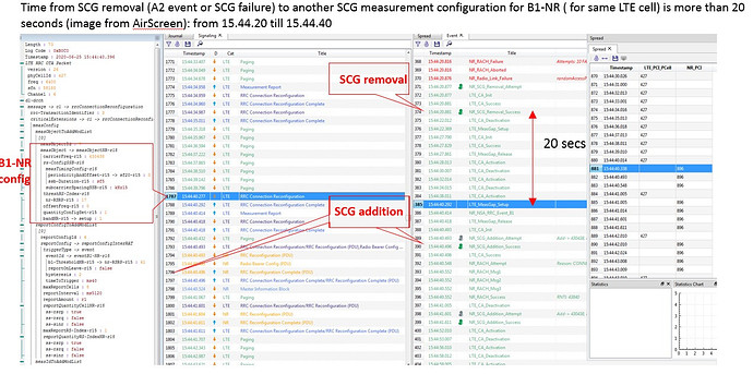

5G NSA question: I’m looking at drive tests in 5G and I see that for same LTE serving cell it takes more than 20 seconds from eNodeB to deliver B1 measurements configuration to UE after an SCG removal. Why so much time like 20 seconds?
See this picture:

Nope, it is long time to deliver measurement config for B1-NR.
It has nothing to do with Ue measurements but with UE configuration to measure B1-NR.
This is my problem, why UE is configured so late to measure NR?
20 seconds later.
Ok after SCG removal ue move to LTE then reconfiguration again send for B1 measurement .
As per you it must not received reconfiguration again to avoid long setup time.
Yes, LTE cell was not changed.
It same PCI 427.
Or it should be deliver faster the measurement config.
Not 20 secs later.

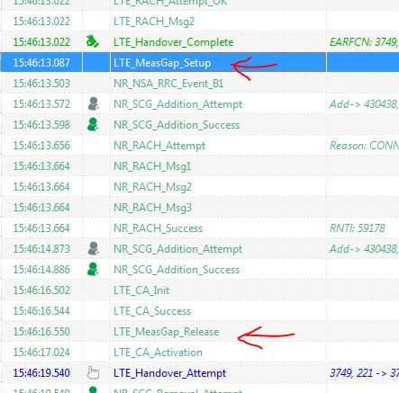

See here how logn it lasts the measurements for B1:
600 msec.
Because it finds 5G very fast.
In other cases will last longer.

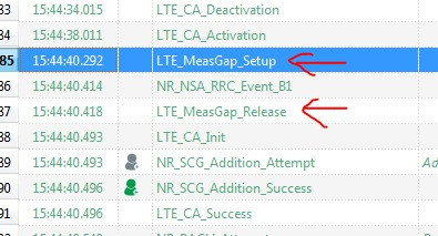

Here is 3 seconds LTE gap:
Which one gap from 0 to 11.
3 ms I think not 3 sec.
measGapConfig → setup
gapOffset → gp0 : 20
s-Measure : 0
speedStatePars → release : null
mgta-r15 : true
It is 3 seconds how long the measurement gaps last see timestamp in my picture for those 2 arrows in red.

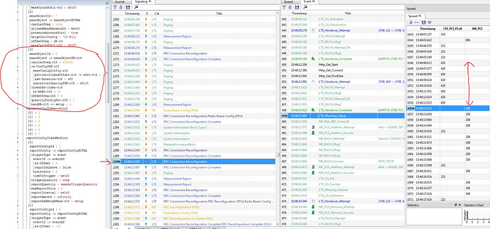

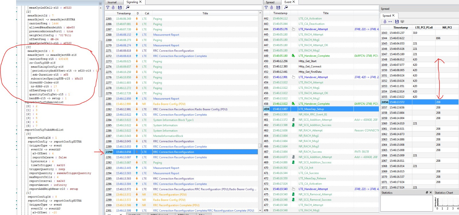

Another case:
7 seconds between HO to a new LTE cell till measurement config for B1-NR is delivered to teh UE:
