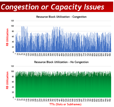

  3. SINR, High interference, Lower CQI, Lower MCS, Low Modulation, BLER
  4. If Max No. of RRC connected active per cell is close/equal to max no of RRC connection supported
  5. High PRB usage, wrong earfcn Definition
