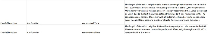

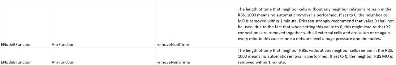

In Ericsson system, you have parameters like removeNcellTime, removeNendTime etc.
You can reduce it to 1 day, so that ANR does measurement and update neighbor list daily.
You can check maybe corresponding parameters for Huawei.
