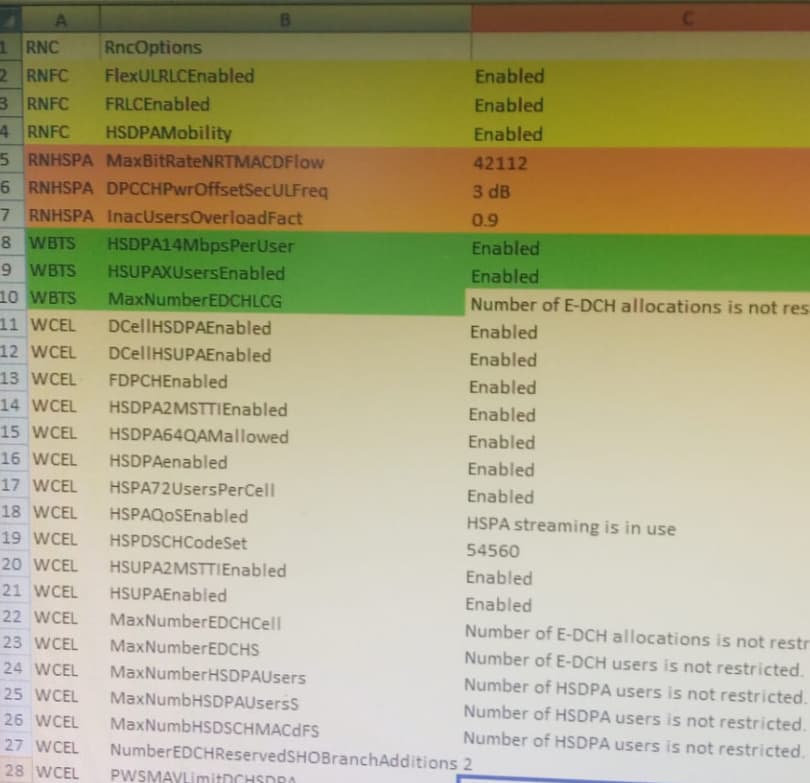

Check your HSPA rate configured in CW.
HSDPA14MbpsPerUser
The parameter to enable
64QAM enabled there?
Yes all parameter configuration seems to be correct only.
Already enabled.
Check the CW. Maybe something wrong for that site configuration.
There is no alarm in the site manager.
Didn’t find any discrepancy in configuration.
Is there any parameter for data rate in the site configuration?
Yes there is in CW.
Take a site working properly and compare both configuration in CW.

Please show the DC configuration parameters you did.
Deactivate the DC HSUPA.
Line 12.
Actually it was deactivated when alarm was there.
And after activation also alarm is there.
Ok. But deactivate it back.
Also:
Are you using MIMO?
HSPAQoSEnabled must be the same value in both cells
No.
That is same for the cells.

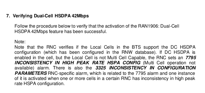

One question:
What does it mean “Local cell is not Multi Cell Capable”? ![]()
Check the MCellHSDPAEnabled
If set to 1, change to 0
