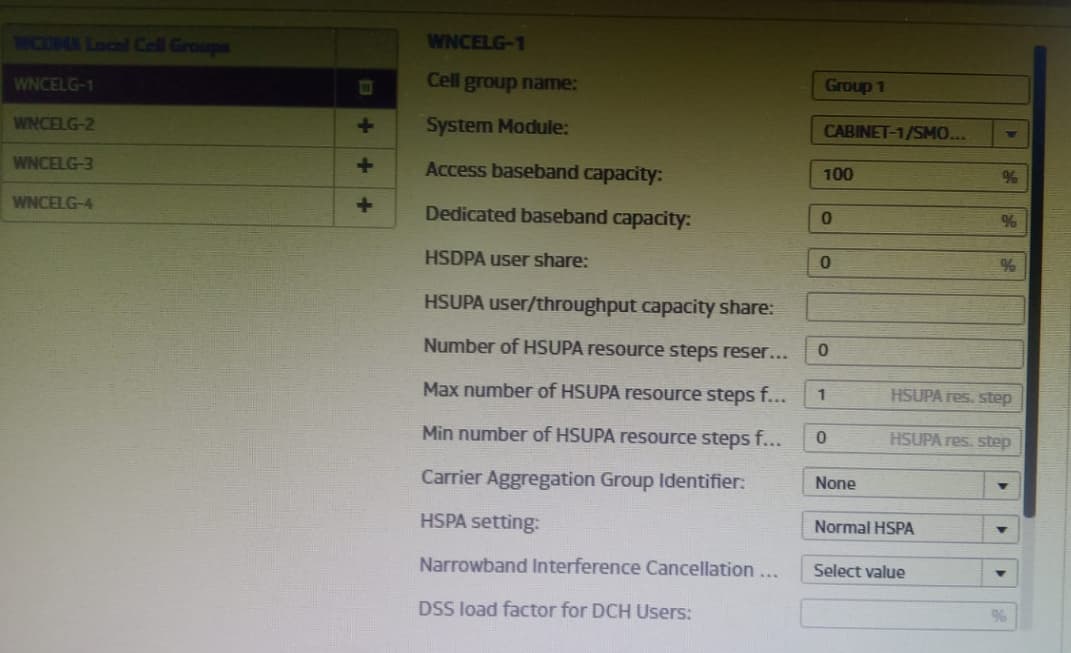

Are these parameters in LCG settings correct? :point_down:
Not correct.
Can you share the same for the 4 LCG?
How are you defining those LCG?
Are they under the same SMOD?
Yes.
Only one LCG for all the cells.
But I see 4 LCG.
No those are not added.
You can see + symbol in the right side.
Oh, ok!
I thought because you selected the 1st that’s why showing +
Do you suggest any modifications here?
Change those 2 to 100%
  • shareofHSDPAUser
  • shareofHSUPACapacity
