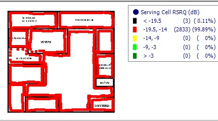

Serving Cell RSRQ (dB):

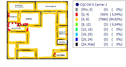

CQI CW 0 Carrier 1:

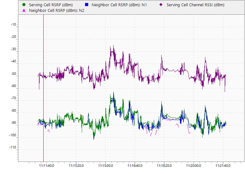

Check this, RSRP in server cell and Neigh 1 are the same:

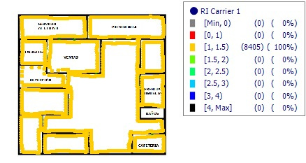

Average and max rank indicator.
If MIMO cables are twisted then rank should always be 1 meaning only 1 layer for MIMO spatial multiplexing.
It’s MIMO 2x2.
Then rank should be always 1 in counters for 2 sectors, not just for one sector.
If you never see samples of 2 layers for mimo then this is it: MIMO cables twisted on site between sectors
Please check counters from several days plotted by hours and see rank indicator or number of layers.
If both are 1 then MIMO cables are twisted.
RI Carrier 1:
So it is always 1 in Drive Test.
This is a good hint I am right.
But check counters for Rank Indicator and MIMO layers.

It may not be MIMO issue but 2 PCIs having same signal strength coming from pretty much same direction.
So again too much overlapping between cells.
It is weird that 2 PCIs have exactly same RSRP as in your picture.

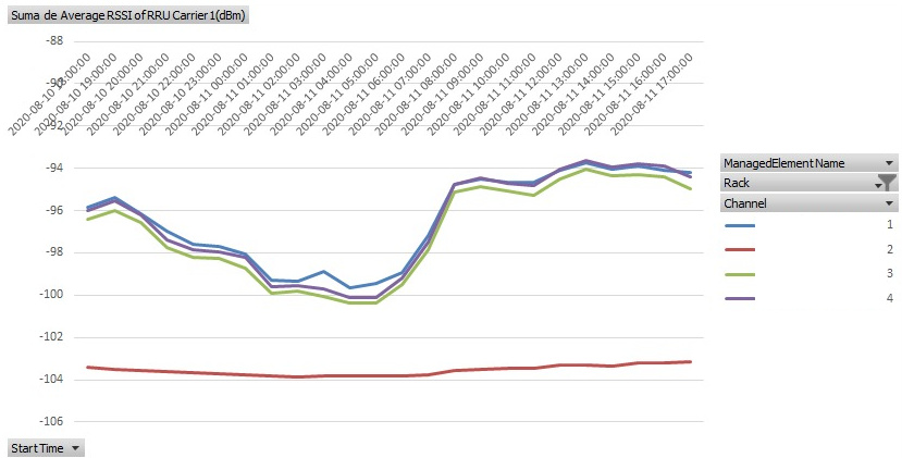

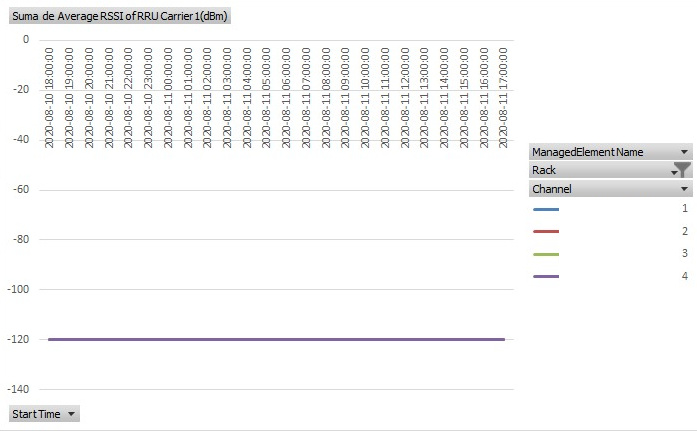

I think that there are bad connections, because RTWP in sector B don’t measure, and in Sector C have one in -104.

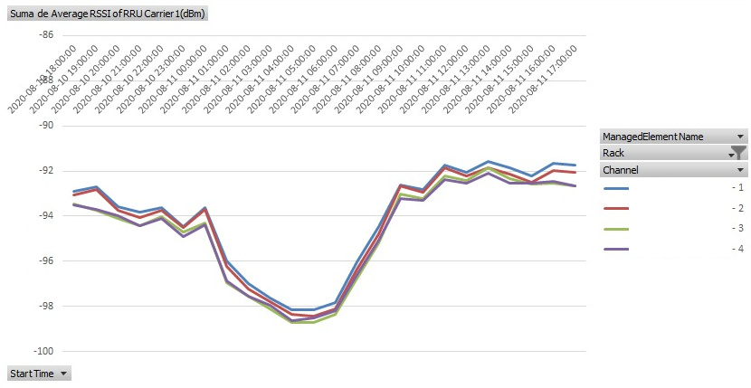

Average RSSI Charts…
Average RSSI Sector A:
Average RSSI Sector B:
Average RSSI Sector C:
Usually policy got wrongly implemented at router end then such cases apear.
This is another problem you have to fix as a flat RTWP.
