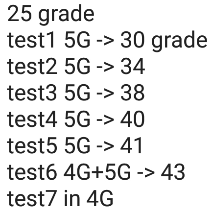

This is the result of test of Samsung S21 that started at 25 degrees:
Few simple speedtestnet overheated the phone.

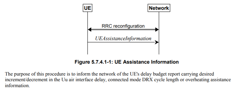

As 3GPP 38.331, The UE shall set the contents of the UEAssistanceInformation message for overheating assistance indication:
  1. UE may prefers to temporarily reduce the number of maximum secondary component carriers
  2. UE may prefers to temporarily reduce maximum aggregated bandwidth of FR1
  3. UE may prefers to temporarily reduce maximum aggregated bandwidth of FR2
  4. UE may prefers to temporarily reduce the number of maximum MIMO layers of each serving cell operating on FR1
  5. UE may prefers to temporarily reduce the number of maximum MIMO layers of each serving cell operating on FR2:
