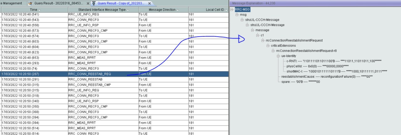

  1. UE setup PSCEL/NSA @604/623,

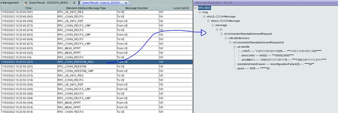

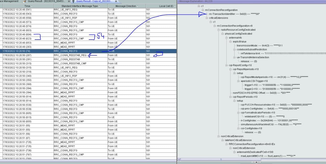

  2. On (74), eNB asked for UE to perform RRC_RECFG, but UE fails and perform REESTAB on another cell.
I would like to understand the RRC_RECFG msg and the failure cause.
It’s mentioned there → it’s reconfiguration failure.

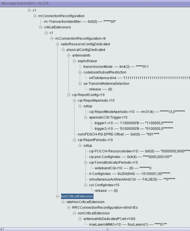

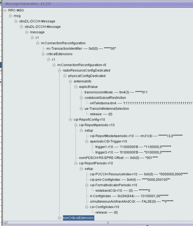

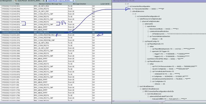

This is the reconfiguration msg, there is no addition of band.
After NSA PSCell is added, enb sends UE info to perform scell CA-Lte addition but UE fails.
Is there a switch to disable scell lte addition after nsa PSCell is added?
Yes, this can be done as LTE CA with 5G is a feature that can be enabled or disabled.
Parameter actCAggrLteNrDualConnectivity.
