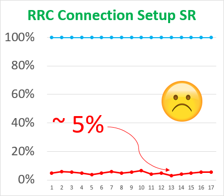

Hi All,
RRC connection setup SR is 5% on one site.
Number of RRC users doesn’t hit on site, timer value fine.

For RRC failure cause, if it is “no reply” for most samples, then it is Radio.
Proceed with more downtilt.
Ok, thanks. Let me check TA sample.
You need to check RRC failures due to “no reply” and due to “cell radius”.
I’m checking contention based RACH SR.
It’s linked with antenna coverage, how far UE accessing site.
This is actually good suggestion. I was gonna ask to check eNB side if any issue.
5% RRC SR means definite issue at eNB.
You can also check Preamble B allocation which usually another indication if more users are coming from poor coverage areas.
