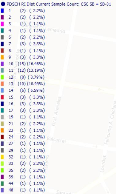

How RI distribution is coming like this (in TEMS discovery) or 5G?
I think first you have to clarify what CSC SB=SB-01 means. may be related to serving beam.
Is this a mmWave log?
Yes, it’s SSB beam one.
But why this many RI is coming?
Maybe RI doesn’t stand for Rank Indicator but for Range Index.
Then you’ll have the number of serving beam inside the Grid of Beams.
Just an opinion don’t take it for granted.
Which Vendor is it?
I think max 4 RI we can go for 5G NR if single SSB then it’s 2.
Please correct if wrong.
You are right, regular should be 4x4 or 2x2.
Maybe new UE with 8x8 but that should be all.
But I think it is not rank there.
Don’t you have a “right click/ atribute help” like in Actix for every IE?
Vendor is Ericsson.
Ericsson uses grid of beams concept that means beams cannot be pointed "anywhe only on specific locations called grid of beams.
This grid of beams covers the whole footprint of the cell and UE is served by only 1 beam index.
I think what you have there is beam index inside the grid of beams.
Yes, I am also thinking,

This is the issue. What does RI means since it ranges up to 48?
This is no RI distribution.
We used to take a different one for that in TD.

1 SSB has 4 CSI RS beam in case of GoB.
Beam refined with CSI RS or SRS.
