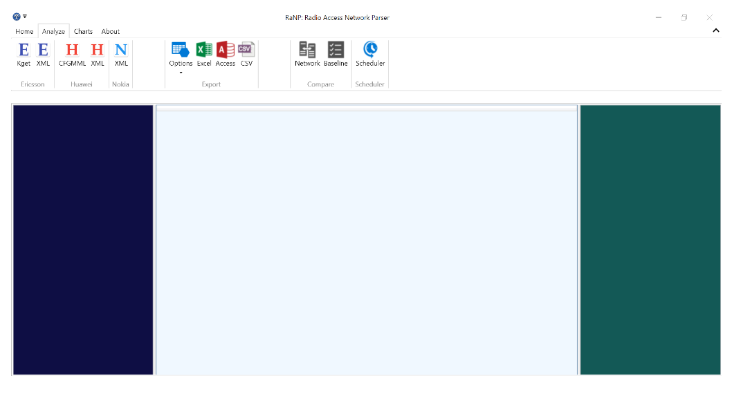

Can anyone help me how to extract with Kget format for Ericsson from ENM for all BTS nodes, and compare it in RANP?
What do you mean by RANP?
this tool for comparing sites basic configartion
Who developed this Tool?
I dont know, heres the site
