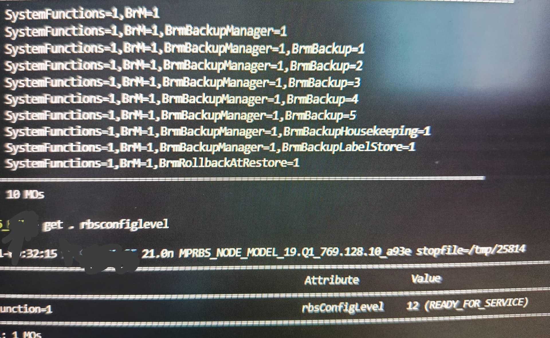

Hi. Ok. It’s the latest UP for 6402 and MO BrmFailsafeBackup=1 should be already present in configuration comparted to L16 versions. Could you share lpr SystemFunctions=1,BrM=1 printout? And get . RbsConfigLevel.
Done…
Hi, Vladimir. I checked it on our node from the same UP and there is no this MO as well. So, I would say that it’s SW bug, but pico6402 isn’t supported anymore. But if you have time for experiments you may check, if this MO is present on some older UPs (17-18), check behavior during SW upgrades and LKF installation.
