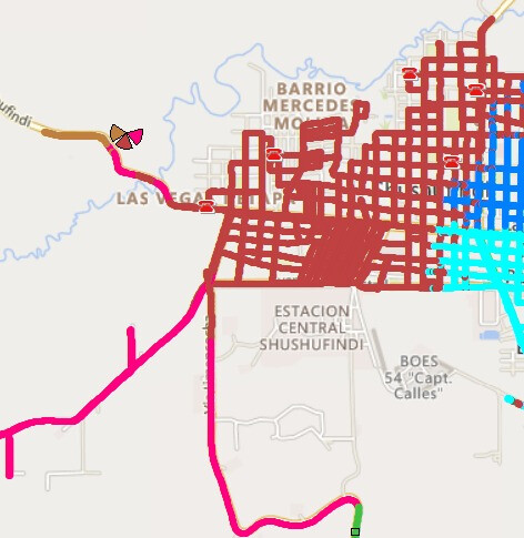

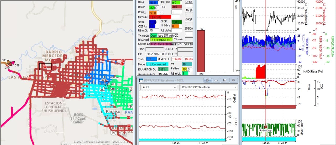

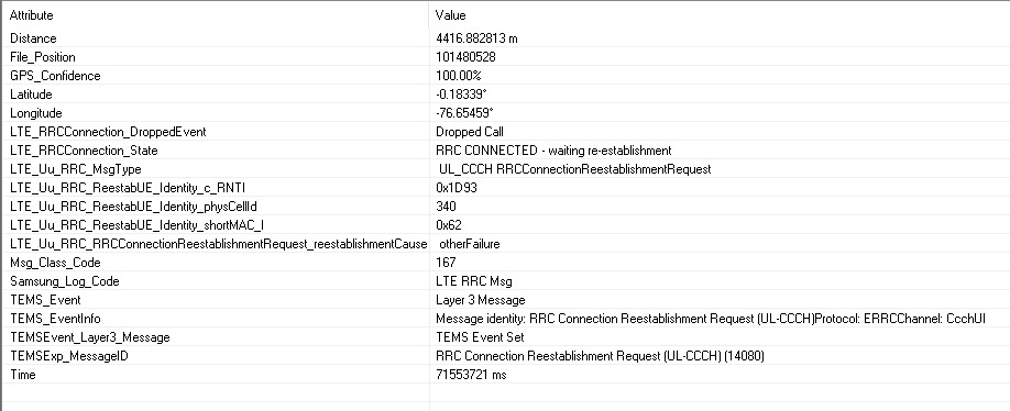

I have this case in LTE Huawei: Radio conditions are OK, BLER 80 and CQI 1, but call dropped.
and have drop.
What can be the reason?

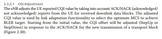

Yes, but in this case retransmition are very high because NACK is high.
CQI Adjustment
Yes and your MCS is at 0.
QPSK.

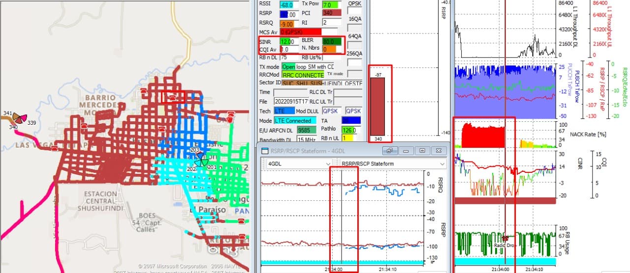

But in second picture if SINR and RSRQ are OK CQI is low.
What is a reason of drop call?
And to have very high retrasmitions?

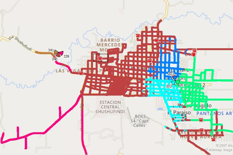

Means you have a TX issue.
Because retransmission should not exceed 2% in IP side.

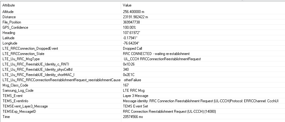

In the same drive test I have 8 events in the sector.
Can you check the Packet loss?
Unfortunately no. I don’t have access to KPIs.
Maybe someone can comment.
You have cross sector…
Check Co PCI.
Yes.
Only have two sites in the zone.
I reported cross sectors to installation group.
Your BLER is very high…
Yes, 100.
That should not be more than 10.
I think that for this reason have retransmitions. Because BLER is very high.
