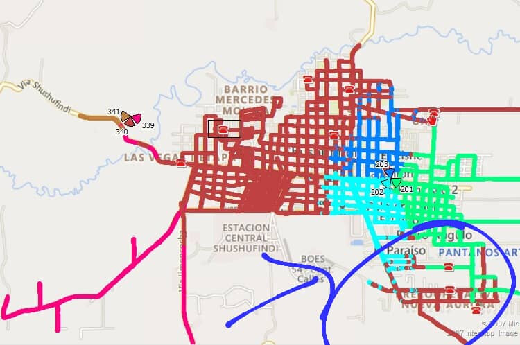

Is is the same cell covering there?

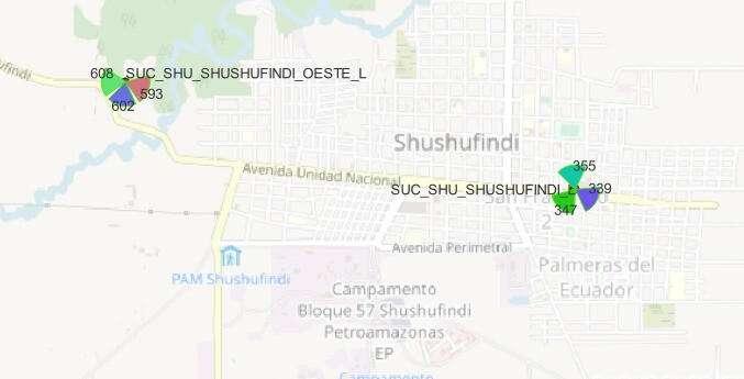

Yes, the site in left have 95 meters high and site at right have only 35 meters.
The site in right side is new.
The other is old, for this reason I find cross sectors.
And these drops that he operator don’t find.
Ok so they must correct the cross sector.
Then review the coverage because it’s overshooting a lot.

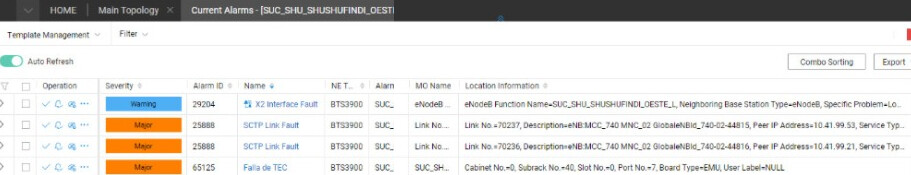

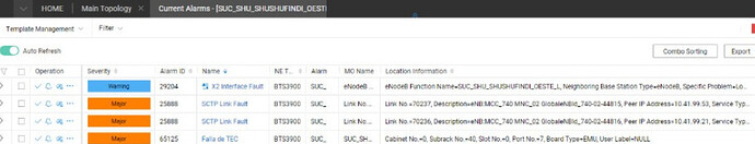

I have this alarms in this moment:
Antenna shoudl never be installed at 95 m height.
No matter how much you downtilt it, it will still pollute and overshoot.
Solution is to lower antenna height to 35-40m from 95 m height.
I told you: check TX.
Thanks, I reported that to team.
The operator don’t want bring down anntenas, this site is in the Amazonas and don’t have another site in 50 km, only new site for the town.
The problem was bad instalation, without alarms
