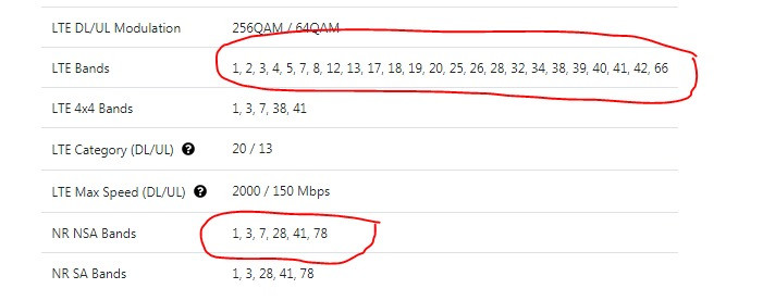

Ok, like CA it means UE indicates combo for ENDC band.
Please tell in which message I can see band combo for B3 + N41.
In UE capability, like this:

Here I’m finding 4 layers for 30 kHz.
My query is that can I find B3 + N41 info in UE capability showing layers info.
As you shown below:
Yes there should be a band combination, search for it.
